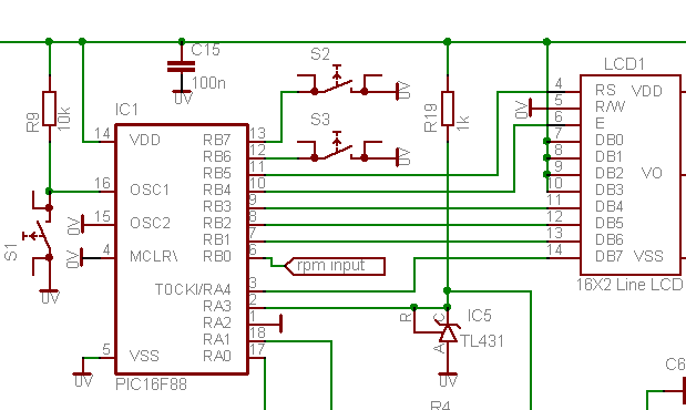

Hi guys, newbie here. I used 16F88 as my MCU and i define the port as below:
__16F88
 __config _CONFIG1,_BODEN_OFF&_WDT_OFF&_LVP_OFF&_MCLR_OFF&_PWRTE_ON&_INTRC_IO
; I/O pin assignments
	ifdef	__16F88
#DEFINE	PGBTN	PORTB,6	; page button   (S3)
#DEFINE	HDBTN	PORTB,7	; hold button   (S2)
#DEFINE	BLDBTN	PORTA,7	; blades button (S1)
#DEFINE	RPM_IN	PORTB,0	; rpm input
#DEFINE LCD_D7  PORTA,4	; \
#DEFINE	LCD_D6  PORTB,1	; |
#DEFINE LCD_D5  PORTB,2	; | LCD panel
#DEFINE LCD_D4  PORTB,3	; |
#DEFINE LCD_E   PORTB,4	; |
#DEFINE LCD_RS  PORTB,5	; /
As I need B5 as my hardware UART, i am planning to switch the LCD_RS to another port which is A6 (RA6/OSC2/CLKO),
A6 buffer type is ST and i had it ground previously. However when I changed to RA6 and reconnect LCD port...it gives weird characters on the LCD.
Is it possible to do it this way? Thank you.

OK. Though it is set as input, but it is connected to ground. Can I use it to interface with LCD_RS?
If its physically connected to ground [0v],, its not in service.
Why is it connected to ground.?
If you want to use it with your LCD, it should be connected to LCD_RS pin.?

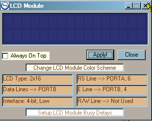

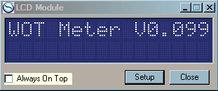

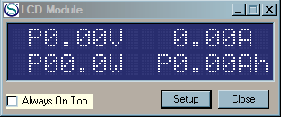

Well, i already tried to compile and changed the bit pattern.
What I get is...
the LCD_RS pin still have to connect to the pin at B5 while A6 is left unground.
If I try to connect LCD_RS to pin A6, it shows nothing .. it just a running characters on it...
Look at these images taken from the Oshonsoft Simulator using your program.
I had to change a couple of pins around so that my Sim would run.
As the program you have is written for the 16F88, which you are using, why do you want to switch the pins about, ie: PORTA,6..???
If you wired it as per the program for the 16F88 it will work.:)

This is the edited version I used with OS.
Dont forget a Sim runs much slower than normal.
Just load into OS, set the LCD 'setup to suit' and run
The image shows the LCD settings for my version of the asm.
I see that there is modification for the pins of LCD...
is this the one u manage to run it correctly?:)
yes it is, OS requires the LCD data pins [4] to be either the high or low nibble of a port.
Hi...
#DEFINE	RPM_IN	PORTA,4;;;PORTB,0	; rpm input
might want to know why the rpm pin is changed as well? Thanks...

Hi...
For the test, I reallocated PORTB.0 to be part of the LCD data nibble.
As the main program uses PORTB.0 on interrupt, you must reassign PORTB.0 back to RPM when you use the original program.
If you connect PORTA.6 as LCD_RS and ensure that you configure as an output the project should work in a PIC.
Always thought that design was a little wonky. Why break up the D4-7 LCD lines? Why not use RB1-4 and move E to RA4. As for counting RPM most might use the TMR0 input (like frequency counters do) instead of RB0. Swap S1 and LCD/RS (pullup built in). Just an odd choice of I/O allocation IMO.
Thanks eric, i will try to implement it. Which means changing the bit mask of A to:
movlw	B'10101111'	; PortA directions (16F88)
and reassign my pins out like follows:
D7-B3
D6-B2
D5-B1
D4-B0
E-B4
RS-A6
and keeps my B0 as my rpm input?
