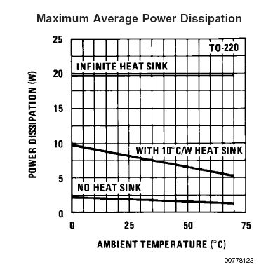

Sounds like you are going to need to change your 7805 to a higher rated chip. I thought that the servos consume somewhere between 400-700mA depending on load. I would check how much current the servo is using to have an idea of how much is the regulator going to have to deliver.
Say you use 1A (that is pretty high for a servo, not sure if it can handle it), then your 7805 will have to waste as heat 7W. A 7805 (in a TO-220)with infinite heat sink is able to waste 20W, check attached graph.

I have a bunch of regular 7805's in TO-220 packages that I'd like to use up, so I'd rather use 3 of these than buy a larger regulator just for this purpose. The microncontroller I'm using runs 3.3v, so this stash of 5v regulators I have doesn't get used much.
I have a heatsink that I stole from an old power supply and by drilling some new holes it should work for all three regulators quite easily. I didn't realize that you could push a regular linear so much farther with just a heatsink.
Just like any power device, without a heatsink they have to be massively derated.
