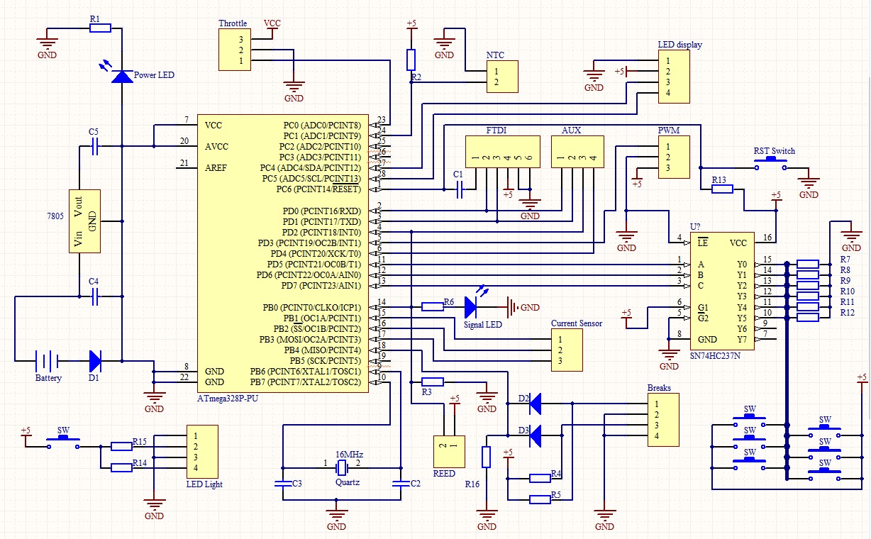

hi ra,
Do you have a connection diagram you could post.?
E
Yep, here it is
Please tell me if you see something wrong
The last problem i had (reseting) is gone. Wire that connects REED, R3 and pin 4 on arduino is really a wire and when i moved it with a finger, the problem was gone.
Also note that R6 is not connected to REED part.
The output of the 7805 seems to be wired incorrectly , as shown on the diagram.???
E.
Why? Now i see that diode D1 is turned incorrectly, but the rest is ok, isnt it? On board that diodes is turned ok.. (and after + of battery)
The whole 7805 seems to be incorrectly wired (apart from the input). The ground is connected to AVCC and both sides of the power on LED :D The output of the 7805 isn't effectively connected to anything :rolleyes:
And D1 appears to be the wrong way round.

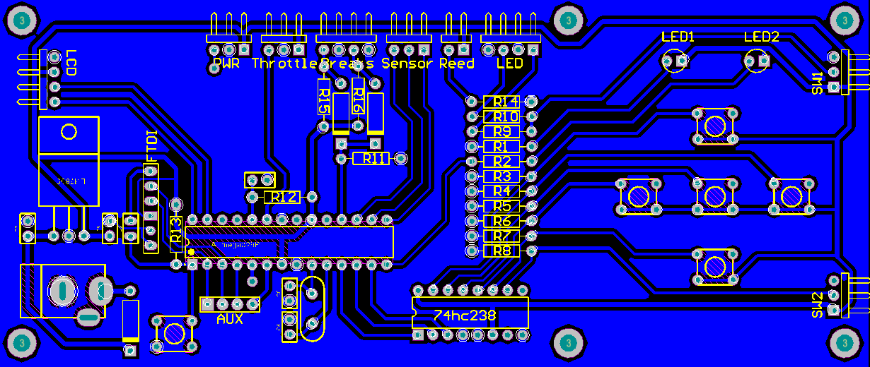

:D now i am confused. I think my schematic is not good. Here is PCB. Power part is ok, because everything is working besides REED relay. Note that on this pcb R14 (from REED) is connected to pin 4 of atmega 328P..
