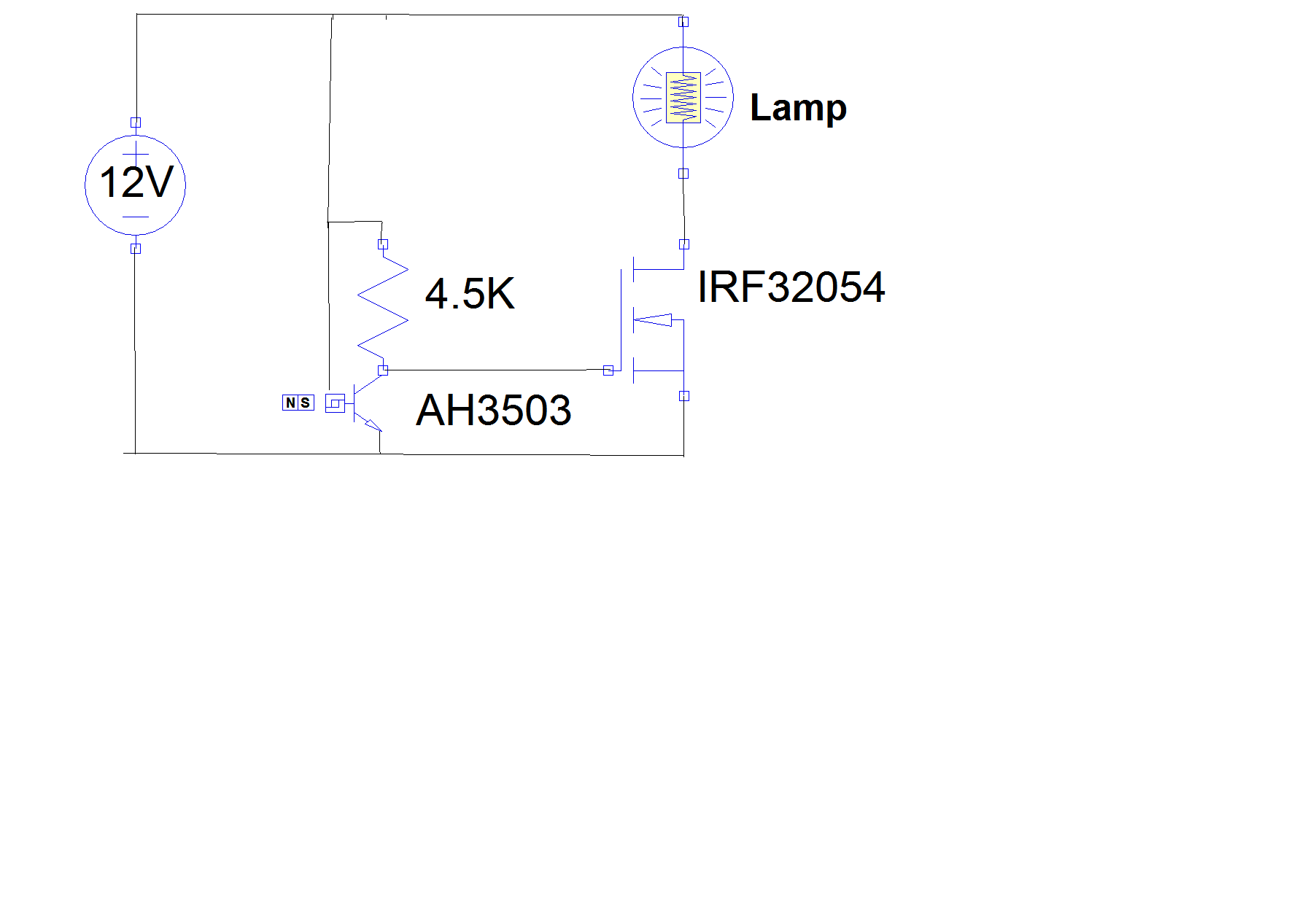

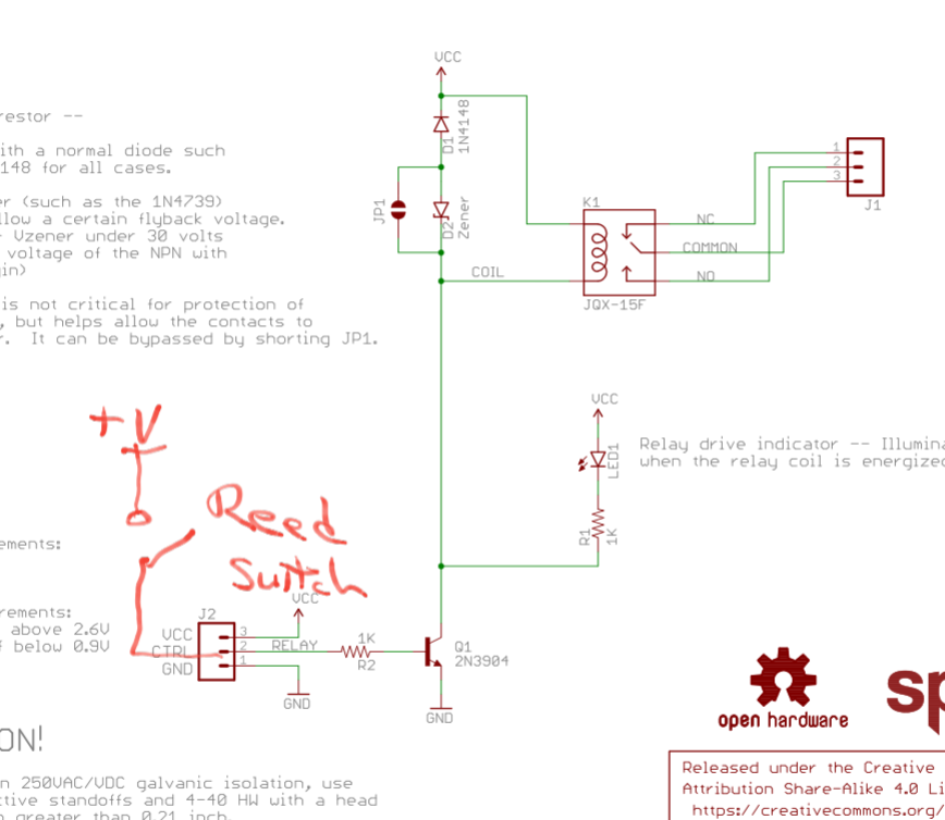

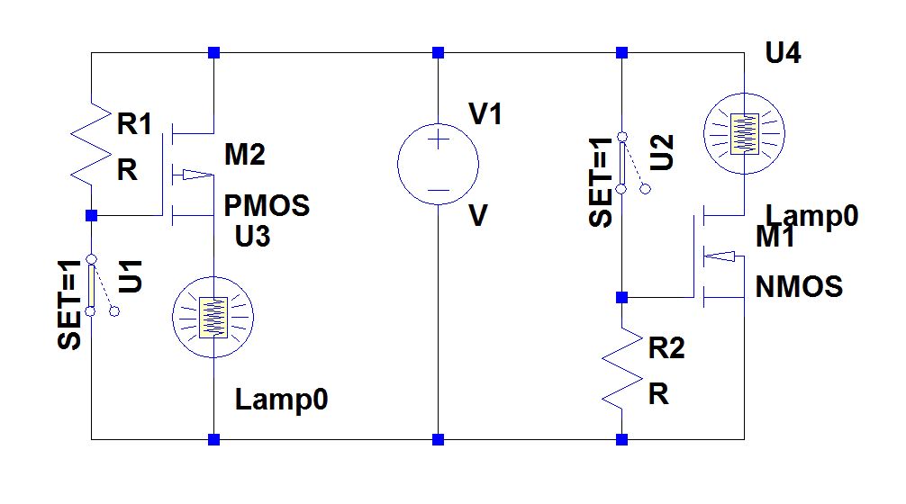

The bulb I'm using is a 7 watt MR16 led. I don't want to reduce the voltage to the bulb. only to the switch. I'm assuming there is some simple way to do this. The reed switch that I tested is rated for about .5 amps, and it seemed to fail instantly. It activated one time and then stayed on continuously.
What is a hall effect device?
Reed switches are EXTREMELY reliable, I'd certainly much sooner use one of those than a hall effect device
Presumably he needs some kind of FET switch, and latching system - I presume it's for toggling a SCUBA light ON and OFF?.
