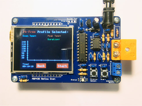

If you are willing to spend the money on the arduino and the shield you have other options.
Here is the first hit "reflow oven kit"
http://www.zallus.com/msp430-reflow-oven-kit/
it has a touch screen
Thanks 3v0!!! That is really nice and priced right too. I will do a little further research on it but that looks SWEET!!
