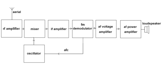

thank you Mr. RadioRon,your assumption is correct and it helped me to go further in my design.As I already mentioned I am trying to construct an FM radio and now I have attached a block diagram can anybody verify it for me please. Also if u have better design ideas,lemme know about it

Your block diagram is incomplete in my opinion because it doesn't show the filters that are critical to the function of a receiver. The most critical filter is the IF filter, found somewhere in the IF amplifier section. Many radios put this filter immediately following the first mixer while some include an additional amplifier between the mixer and the first IF filter. Can you guess why?
Other filters that are important include the de-emphasis filter which goes between the fm demodulator and any af amplifiers that follow it. It is also quite common to include a bandpass filter before the rf amplifier and between the rf amplifier and the mixer. Can you tell us why those are necessary?
I would like to know what frequencies you wish to receive with this receiver, can you tell us?
Don't forget the limiter.
Good point. I did not show it separately as the IF amp usually does this by saturating its output. This implies that you need a lot of gain in the IF amp, and this is generally true. It is not uncommon to have over 100 dB of IF gain so that the amplifier output limits on signals not far above the noise floor of the receiver.
I didn't think about that, that you could actually do that by over driving an amplifier, but that is true. I was referring to the diode limiter. I know you know that...lol.
Anyway, how are you doing radioRon? I got into building a PLL just a single loop so far. Well, I was looking at the frequency and all and said to myself. Hmmm...I need a new radio. So here I go. I got the 1st IF strip and rf amp and home made crystal filter & mixer done and in a metal can. Great performance so far. I'm on the second IF with mixer. Audioguru gave me some tips on good stuff to use in the audio so I got a few chips on the way.
