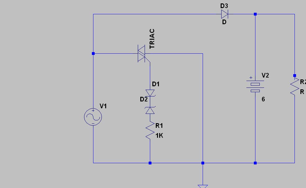

All that sounds like fun but i don't think my xt 500 has a self regulating coil. i have blown 4 bulbs in a week and a half and they are hard to find now 25 years later. for the moment i have a very crude regulator that stops my battery boiling. a triac shorts the coil triggered by two zener diode in series anode together. my scope tells me it works a bit but it is too crude.
no body has better ideas?
scr are used in industry regulators but i have no idea how to use them in a shunt circuit.

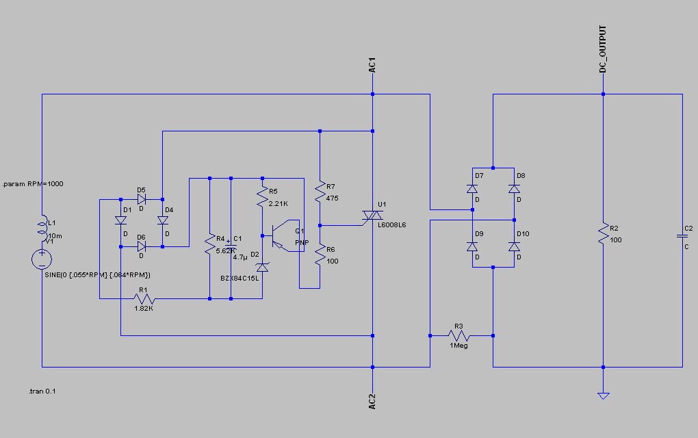

i have found a circuit on the net that uses a triac but when i try to model it in spice it regulates at 2 volts (and only without a capacitor). could anybody have a look to see if there is an error.
The coil produces enough power, other people have already done this with a regulator for a skidoo (snow bike). the circuit below is supposed to be be the same. if you speak French i can give you the site where people explained what they have done.
can we presume that the coil (the V,the I and so the power) will be at the end of the wires. all i need is a good regulator.
this is the 3rd circuit i have posted. triac, scr, or transistor can nobody help me? (please)

So the XT500 is different then if it has a regulator - but why not just replace it if it's faulty?.
Have you disconnected the chassis side of the XT alternator coils?, otherwise you're shorting things out.

The original regulator had blown and the circuit was filled with resin. i took the resin out of the heat sink with a blowtorch and i saw about 10 burnt composants. i put the crude circuit with a triac, 2 zener diodes and a 1k resistor. it was for 6v and i want to try 12v.

in the meantime... mosfets in all that. looking though all my electronic stuff i found a bunch of mosfets. is it possible to use them in a shunt regulator? how o they differ from power transistors?

ok i went to yamaha and the fly wheel came off with the right tool. unsoldered the mass, so now i can fit a 2 wire regulator and have full wave rectification.
now i just need to buy the parts and build the circuits. i think i will try several circuits.

Hi Neil, my XT500 is modded to use 12v system, with the orig stator coil, 12 reg and 35w headlight. The headlight dims a little at idle but when riding it is fine.
You don't have to rewind the stator coil if you are happy with a 35w headlight. All you need is a 2-wire rect/reg from a little modern motorcycle from the breakers. Most of the scooter type bikes and a lot of the 250's use a 2-wire (single phase) 12v rect/reg.
These usually have 2 white wires for the ac input and red/black (or something and black) as output wires. I wouldnt expect to pay more than $25 to $30 USD from the breakers.
If you can get a CHEAP 3 phase motorcycle rect/reg you can use that, they just use a 6 diode rect instead of a 4 diode rect, so you can leave one of the 3 AC input wires disconnected and it will work fine as a single phase rect/reg. They are typically quite crude, using 3 diodes and 3 SCRs as the "6 diode" rectifier, with the voltage regulation done by components on the 12v output so leaving one AC input wire disconnected makes no difference to its operation.
If I remember right the XT500 forum has some threads showing how to wind the stator with more turns but this is only really needed if you want to run a larger headlight like a 60w+. I decided not to bother with mine.
