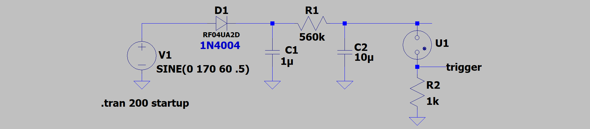

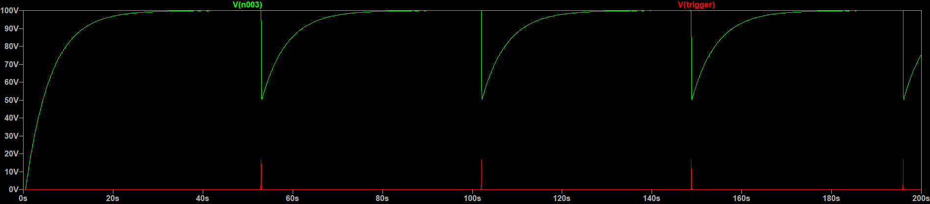

Attached is a possible start for your project.

"There is a neon bulb in LT Spice."
I would like to say 'I don't know how I missed that.", but actually I do. Ah well, life is choice.

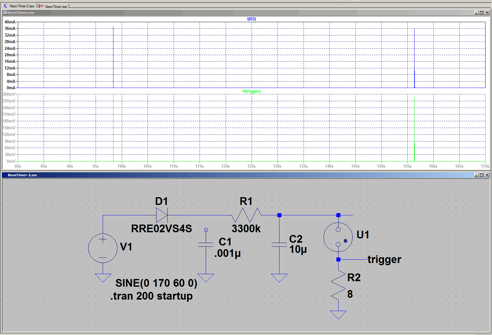

Here is a re-work of #12. I decreased the breakdown voltage to 90 V based on several NE-2 datasheets. They don't list the extinguish voltage so I left it at 50 V. R2 represents a small 8 ohm speaker to make a "tick" sound.
The LTS model has has a parameter called "Zon", which I assume is the effective resistance during conduction. It was set to 2 K, and I decreased it to 1 K just to see how it affected the output.
Disconnecting C1 lowered the oscillator freq, making for a smaller C2.
ak

Thanks for the refinement AnalogKid. I had an idea that I thought might work, but it was late and I just threw the concept together without spending much time on refinement.

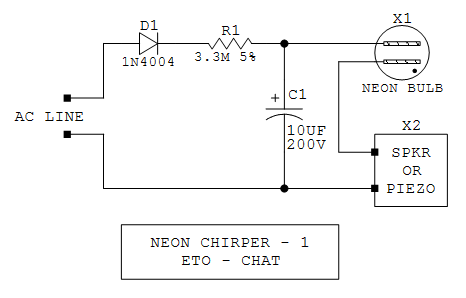

Here is a real schematic.
Built as shown, with an NE2H bulb and 8 ohm speaker, periods after the first one are approx. 48 seconds. Pretty close to the sim, considering that the H bulb has different voltages.
BUT - the tick in the speaker wasn't very loud. A 4" general purpose spkr was louder than a 2" laptop spkr, but neither would get my attention if I weren't waiting for it.
Next I tried an assortment of piezo integrated beepers, the kind with a 1-transistor oscillator built-in. Most were better than the speaker, primarily because a short beep is much more noticeable than a tick. One is pretty good, but it is about the size of a golf ball.
The problem is total energy. If a 10 uF cap discharges from 90 V to 50 V, that is a total energy of 0.028 Ws. If the discharge lasts, say, 100 ms, that is a brief 1/4 W pulse, some (much?) of which is dissipated in the bulb. With an 8 ohm speaker the peak power at the start of the tick was around 7 mW; not very much. Not surprising since LTS thinks the internal impedance of a conducting neon bulb is around 2 K. This suggests that a high impedance sounder like some kind of buzzer or beeper will get a larger percentage of the available power.
