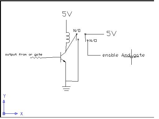

Guys, i had attached the circuit diagram here.
If Or Gate output is 1 then transistor will be turned on so that relay will be turned on also. Now, if Or gate output is 0 , transistor will go off but relay will remain on until user remove the source voltage. But, i think there are some problems with my circuit because AND gate will be turned on when my OR gate output is approximately equal to 0( OR gate inputs: A connect to ground, B connect to Vcc=0V).But now, output of OR gate still can turn on my Transistor.
In fact, an astable pulse will pass through AND gate when it is enabled. I measured the input of AND gate from relay, it is 1.2V. This voltage is enough to trigger AND gate and hence Astable signal can pass through AND GATE. This is not the result i want.
guys, please help!

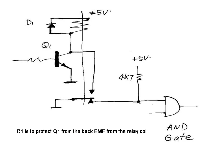

What type of gates are you using? The 74LS series or CMOS?
I suspect it is the 74LS series. If so, then the AND gate is not seeing any change when the relay closes. In the case of TTL gates, an open is equivalent to a high. If you want the AND gate to see a change, then its input must be switched between +5V and 0V ie. gnd.
Tha attachment shows how you could do it.
However, why use a relay? A Flip Flop would be simpler and cheaper.

Anyway, thanks for your helping. Your provided circuit is also same problem with my circuit. Since i found that there is a 5V transient voltage to turn on the transistor. Thus, i had used J-K FF to replace this problem circuit.
