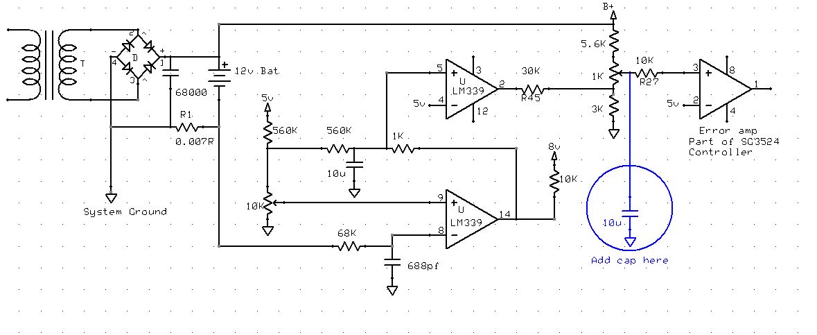

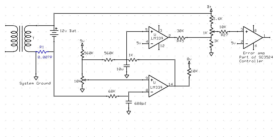

The circuit for the voltage control is attached.
When the charger is on the drop across R1 is greater than the preset and pin14 goes low, this in turn pulls pin2 low and adds in some hysteresis to the voltage divider detecting the bat voltage. When the set voltage is reached the current slowly drops until the whole circuit flips to a low voltage charge strategy, about 0.6v below the higher charge level.
It appears that this low level voltage charge rate is around 12.9v so close to the batteries rest voltage and all the pins on the 339 are just hovering around the flip point. When the charger tries to come on at such a low charge rate everything is so delicately balanced I think the charge pulses cause the circuit to flip and hence the sudden large pulse...... a guess of course.
So I was thinking of clipping R45 out of the circuit completely and doing away with the low charge mode as I do not need it
Or to put cap on one side (or the other) of R27 to smooth the error amp input signal, not sure what size or which side as the cap may discharge into the amp?
Any thoughts?

There seem to be a few probs with the circuit:-
The transformer secondary is shorting the battery :eek:.
Is pin 5 connected only to the 10u cap?
1k in series with 560k is pointless. Or is a connection point missing?
Not pin 2?
Well spotted the xfrmr short, was a bit lazy and forgot to add the bridge and smoothing cap....as my mouse hand is in plaster at the moment.
Also changed the diagram to show the pin5 and 10u cap connection better as they are connected to the 1K, so that is why I reckon if pin14 is low then it flips pin2 low as well.
Have shown a possible position (in blue circle) of a proposed cap that I think will cut off fc at 3Hz and may smooth pulses from entering the error amp - though my resistor network cap filter theory is well rusty.
OR add the cap and also clip R45 out of the circuit.

I think the cap would be more effective the other side of R27. Against that, R27 would then no longer protect the comparator input from cap discharge. Removing R45 would shift the voltage trip point significantly. How would you then prevent over-charging?
That is a good point and I had'nt thought about that because R45 is part of the divider network when in charge mode ie 3K//30K so the 3K resistor should be replaced with a 2.5K. Or I could pull pin5 low all the time but that still leaves a 339 in circuit that may flip.
The 1k pot has been relocated to the case so the charge voltage can be adjusted from 13 up to 16v and we monitor it very closely and turn it down to float level when fully charged so the auto float function is not needed. would get a lot of glue out of the way and simplify.
If we charge to 16v (equalise) the amps never fall low enough to trip the charger into float, so we dial it down to say 13.4v at which point the current is low enough to trip into float mode and that means it falls to 12.8 volts and that is when the pulses start.

Quantised, are you sure the cap at pin 8 of the 339 is 688pF? Strange value. It gives poor filtering of any spikes on the 7mΩ current-sense resistor. Simulation shows 680nF gives better filtering (if the pin 9 trimmer is tweaked accordingly).

It has snubber circuits on the triac and these maybe outdated now by modern methods but it seems to work ok most of the time, had to swap the MAC223 for BTA26 after it blew a few years ago so maybe the snubber is not suited to the BTA26???? Do you want the triac circuit posted.
Alec - Pretty sure it is 688pf but would it matter if the R45 is clipped as the whole circuit would just float. I could put say a 1u tant in there though as I have one of those in the scrap box.
I assume by 'clipped' you mean open-circuited rather than bypassed? I guess try it and see, and it wouldn't hurt to stick a tant in there first, though, to see if that fixes things. But if you're going to be manually monitoring the end-of-bulk-charge anyway, isn't the whole circuit redundant? Or have I missed something?
