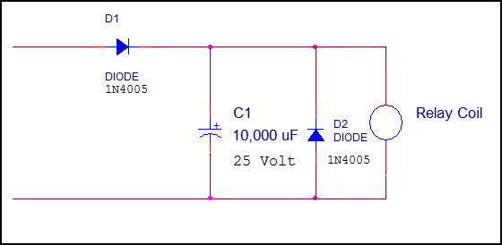

You can try something like the attached. I am not sure that when calling for cooling the cap will have time to charge before the battery voltage drops. The diode across the relay coil is just there as a snubbing diode. You could likely use a 1N4003, 1N4004 or anything above 1N4002.
Ron

Ron,
Thanks for that diag.. but thats simlar to what I have areay done, with the result you spoke of .. the cap take to long to charge, it will actulay make it chatter more!!
what I remember was a cap and resistor w/ a zenier diode to keep the cap charged. the zeiner passed the current to the coil and the Resistor backed up the flow of current and was before the Resistor, and would allow the cap to retain a charge at a threshold just below the zeiner's break down voltage.

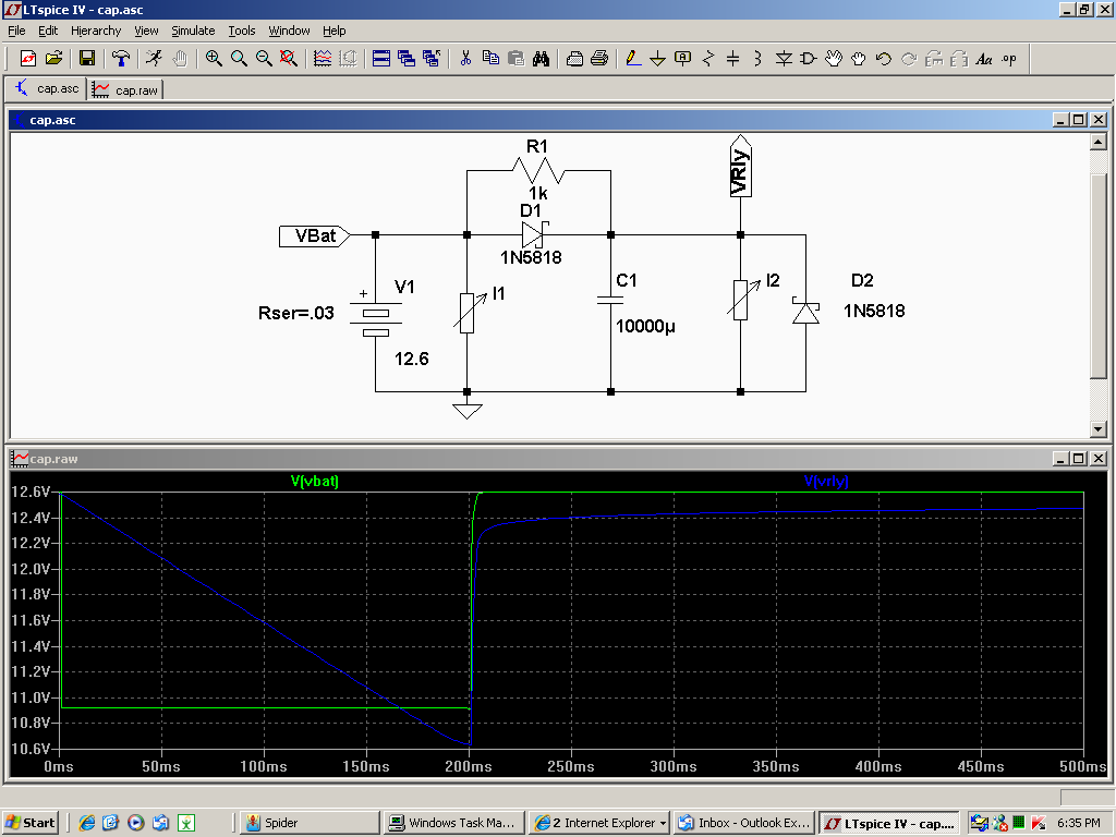

You don't say how much the coil of the relay draws. That will determine to some extent the size of the cap. For the battery voltage to drop below 11 volts the internal battery resistance is .03 Ù or so. This seems a little high to me. Use a Schottky diode it will save you a little drop. Below is a simulation for a 100 ma coil. It only buys you 150 ms or so. So if the coil draws that much a bigger cap may be in order.
