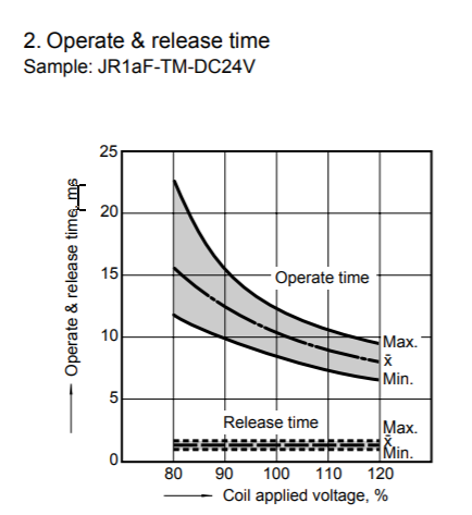

Hello . I would like to ask a few questions about DC electromechanical relays. let's consider a quantity of signal relays that are all the same. the relay contacts take a certain time to close and a certain time to switch off. I assume that each relay has slightly different closing and opening times than the others. how much could the difference be in milliseconds?. I don't know yet if it's worth it, because I don't know how much time difference there is between one relay and another, the need is to obtain perfectly synchronized closing and opening of the contacts of all relays. in case you need to turn on and off a small group of relays, say three or five, instead of powering the coils together individually and in parallel at the same voltage is it possible to power the coils in series using a higher total voltage? does this solve the problem?
Relay data sheets will have a graph, similar to the attachment, giving you the info you need. Relays contacts will chatter (open and close multiple times) until they permanently close after the voltage is applied.
Wiring the relays in series (using the proper voltage) will not change that as it is a mechanical property of the relay. E

Also the common practice of placing BEMF diodes across DC coils causes a delayed drop out situation.
If you need high prescision synchronization, maybe look at a solid state solution.
Max.
Series relays will cause more issues and will operate slower. Connect them in parallel and run at a slightly higher voltage than nominal. This will make them faster. Be sure to use a diode around each coil. But a parallel connection will not eliminate contact transfer time manufacturing variances. When it was critical, We actually had an automated test fixture to perform a specification check on each relay.

I've used Zener diodes before as back EMF diodes for faster relay shut off.

The contact-bounce (chatter) can be reduced using a bifurcated relay. These type of relays are used in old telephone systems and any low-level circuit where relays (or switches) are employed.
When designing software a routine is called to wait for the end of the bounce before the next program is executed.
If timing is important a solid-state relay could be used. E
