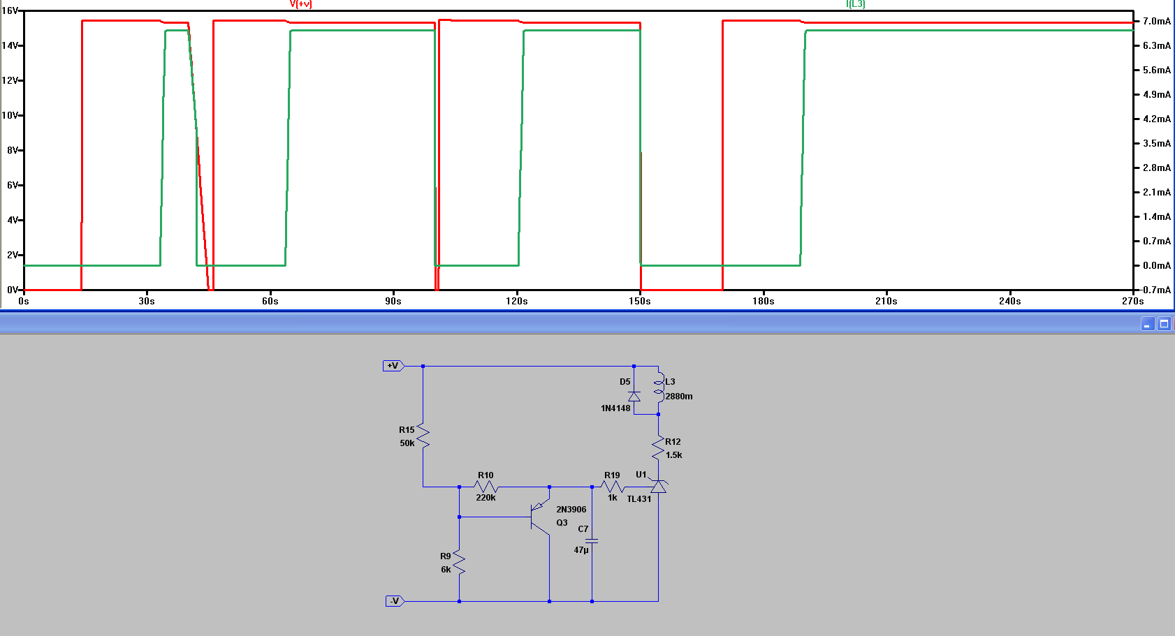

Added a pic of the simulation graphs im getting at the minute. Seems to be ideal

I think it could be simplified.
I assume that U1 is a SCR. I don't have a data sheet for it.
I feel that Q3 and some of the resistors could be removed.
My idea is that you can discharge C7 by connecting a capacitor from the switched side of the -16 V line to C7. Thus when the relay operates, C7 is discharged.
Then when the power is turned off, U1 goes open and the circuit goes back to its initial state.
You would need a diode across C7 to prevent it charging too far in the negative direction. It may even have to be a germanium or Schotty diode in order to minimise the reverse voltage.
Otherwise, U1 may be switched off by the negative potential. I would have to look at its data sheet to be sure.

Also, I see that U1 is a regulator, not an SCR.
I studied your circuit and now realise that U1 is a shunt regulator, not an SCR.
That is a novel idea.

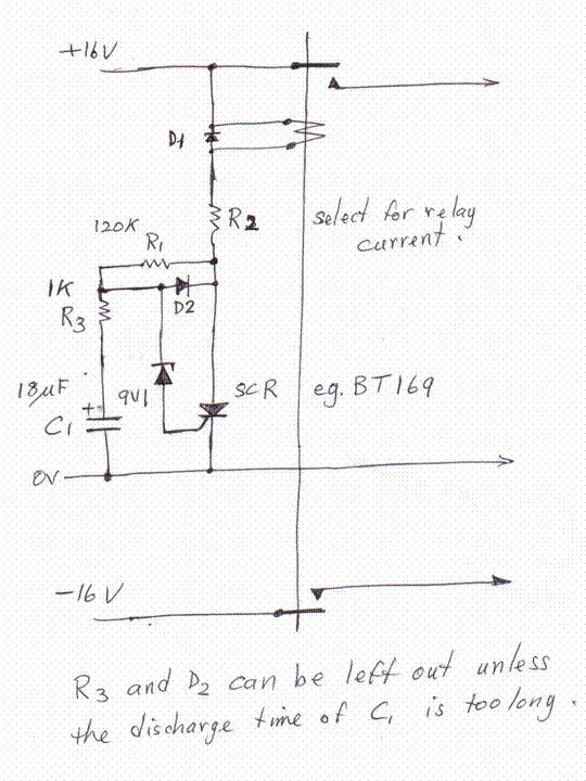

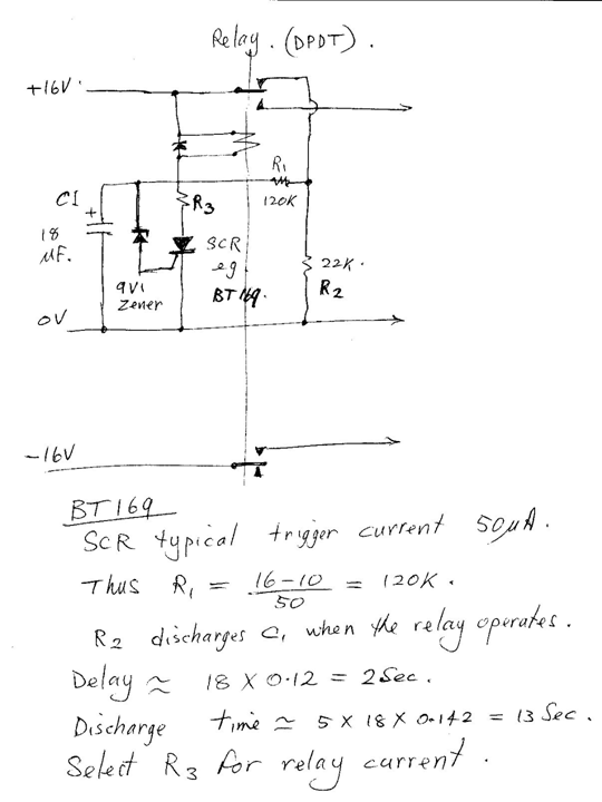

Attached is my suggestion using an SCR.
C1 delays the operate of the relay by about 2 sec.
The 9V1 Zener prevents the trigger of the SCR until C1 has charged to about 10 Volt.
C1 starts discharging immediately the relay operates and needs about 13 sec to fully discharge. If that is too long, it could be reduced significantly by connecting a diode across R1.
This would reduce it to about 2 sec. It could be further reduced by reducing R2 to 10k.
The circuit can operate from either 16 Volt as shown or 32 Volt.
For 32 Volt I suggest that you would use a 22 V Zener and R1 could be reduced in value.
I don't know if this circuit has any real advantages over yours. But I've posted it anyway.

Here is a better option.
The discharge of C1 starts when the SCR conducts.
If D2 & R3 are included, the discharge time of C1 will be about 100 ms.
If they are not included, it will be about 13 sec.
