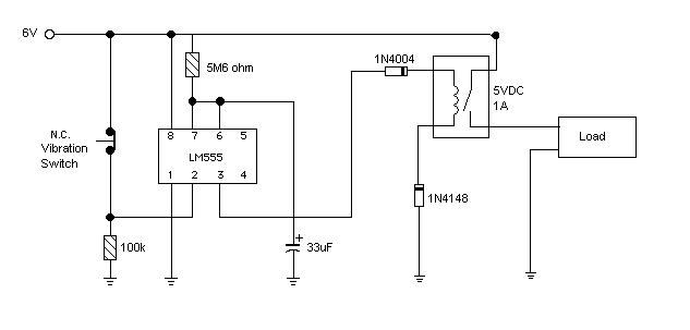

Hi all,
Alright, the circuit uses a vibration switch to trigger a 555 timer which runs for about 3.5 minutes. The output of the 555 drives a 5VDC 1A relay to a load. I know that the 555 timer cuts off, but the relay does not, retriggers the 555 output I think. I have put the required 1N4004 and 1N4148 diodes as seen in other circuits, but this does not address the problem.
Any ideas on what else I can do or perhaps some ideas to improve the circuit? I do need to use the 555 and would prefer not to swap to a different IC.
Thanks.
I have attached the circuit below.

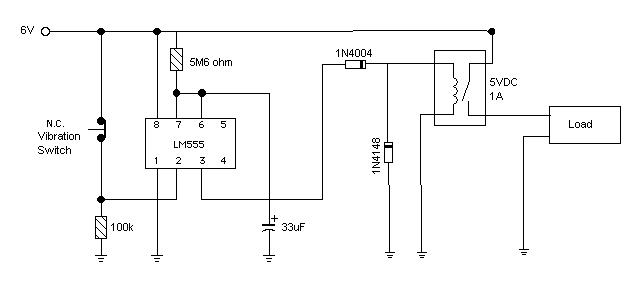

Doesn't the line on the diode indicate the direction of current flow?
Well, I've wired it all up as per the circuit, with the protection diode as per the following tutorial that I referenced.
Main issue here is - it all works fine on the breadboard!!! But when I put it on the PCB, it doesn't.

you dont have a ground for your relay!
are all your solders clean and making contact, because if it works on your bread board then it should work on your PCB.

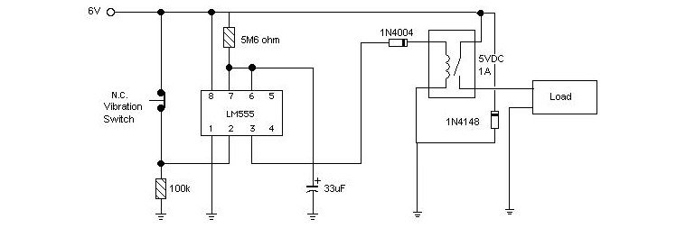

You're absolutely correct, I'm just lost with it all.
The correct circuit is attached below. This follows the correct protection diode diagram as above.
I've checked the soldering and tracks and everything.
I'm wondering if the 1N4148 is not right for the relay? Should I be using a different diode?
If your vibration switch is still open when the 555 times out, the output will stay high until the switch closes. If this is the case, you need a differentiator between the switch and pin 2, so the input pulse is shorter than the expected output pulse. A differentiator for this circuit needs special attention, or it can destroy the 555 with overvoltage on pin 2 when the switch closes.
A couple of suggestions. 1. Connect a 47 uF electrolytic capacitor between pins 1 & 8. + of the capacitor to pin 8. I have seen 555 timers act erratic with out a bypass capacitor from the Vcc to ground pins. 2. Change on the 33uf capacitor to a low value like 4.7 or 10 uf and see if the relay deenergizes after 28 sec or 60 sec. Some times the leakage current of electrolytic capacitors on the 555 prevent the capacitor from fully charging. If the relay operates normally with a small value the larger capacitor could be the problem.

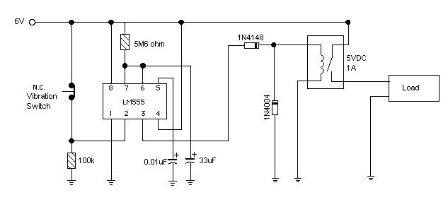

EDIT; The 1N4004 should be across the relay and the 1N4148 from the 555 output to the transistor base.
Hi Eric,
Is the attached circuit what you are talking about?
Swap the diodes over and then connect up pins 4 and 5?

Ref the diodes, I did misread your circuit, woops!. I would use a 1N400X in both locations.

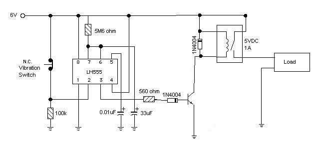

I will also try to put a NPN transistor to drive the relay. I've got some BC548 NPN transistors. What size resistor should I put for the base? Would a 1k2 resistor be correct?
So collector connected to Vcc, relay coil connected to collector via 1N4004. Base connected to 555 output via 1k2 resistor and emitter connected to ground.

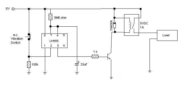

Look at this drawing.

I've done some testing with the recommended circuits, but the relay still at certain times, does not cut off.
I've added a diode to the base of the transistor to try to cut off any reverse current to the 555 timer.
Would appreciate any comments if this is suitable or if there is a better solution?
Preliminary testing with the diode in place appears to be satisfactory.
Thanks.
