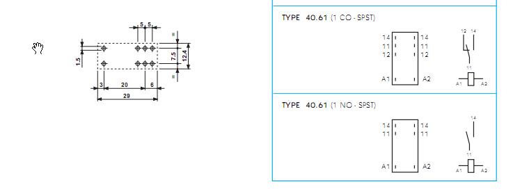

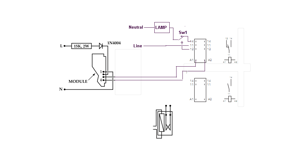

hi i am really confused i have a relay for a unit that i am using that i have questions for
to start i am using timeguards meu11 as a lighting timer i was told it is possible to do so here is the link https://www.rapidonline.com/Cables-...461/?sid=af860032-4104-4fe1-a101-b8c2969d0452

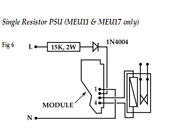

they told me all i need is a 15k relay diode and relay for it to work so i bought the things needed and im using figure 6 on the meu11 data sheet https://www.electro-tech-online.com/custompdfs/2011/10/23-5461.pdf
the relay i have is the one they specified 48v 16a spdt relay https://www.electro-tech-online.com/custompdfs/2011/10/23-5461.pdf
the question is i have no idea how to wire the relay or what pin to put it in any help about pin out of relay and how i should be wiring it up to switch 230v lighting
many thanks
jak
That last link, I cannot see the relay details, whats the Rapid Part No.???
**broken link removed** heres the relay rapid number is 60-1045
There is a small difference, which of these two types from the data sheet... see how many pins there are on the relay.

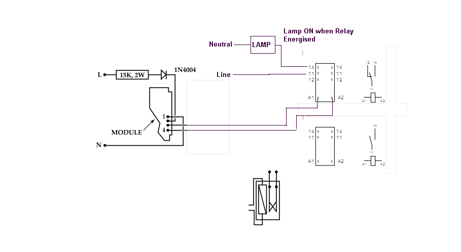

Look at this image for the connections.
If in doubt, please ask..

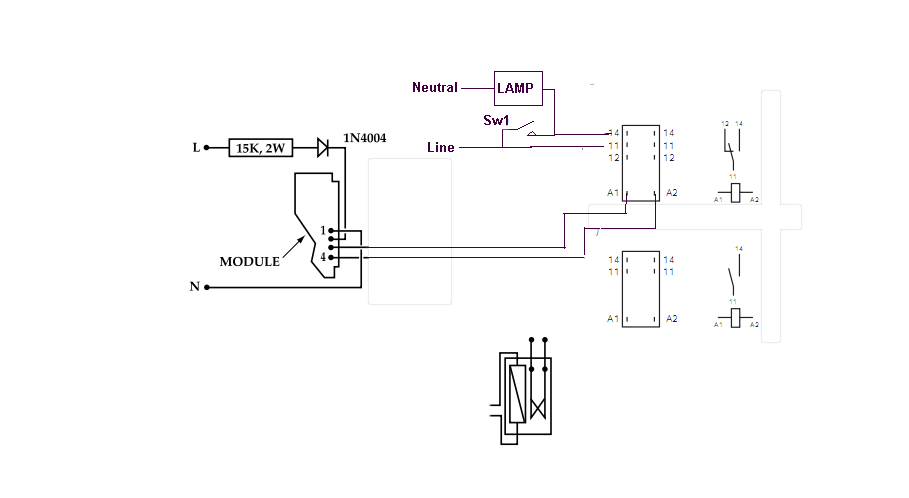

thats perfect thank you i have the CO one the one with 8 pins and will this switch 230v? and if so is there a way of putting a switch in?
The relay is rated for 230Vac mains voltages, so it will be ok for a lamp.
Do you want to switch the Lamp on/off independently of what the relay is doing.??
so that if the timer stopped working i could still turn them on i think that would be best
The simple version is image3, shows a single pole light switch, you can turn ON the light as required.
Image2 shows a light changeover switch, the type thats used on stair landing lights, this allows you full control over the light ie: On and Off.
Please care with mains supplies, make sure the relay, diode and resistor are fully enclosed in an insulated box...

ok i wired it as per your drawing and nothing comes on no lights nothing the unit doesnt even start up what am i doing wrong?
Are you saying that even the manual push button switch does not turn the light ON.???
Can you post a picture of how its connected together.??
the manual button works but the timer doesnt even turn on
Is the diode the correct way around and connected via a 15K resistor as shown in fig #6, of that datasheet.?
Also have you connected the mains supply to the timer as shown fig #6.?
