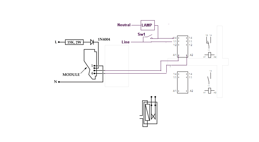

If I attached my voltage to the wrong side of a 1n4004 will it damage it
Do you mean if the diode was reversed or the Line wire directly to pin2.??
If yes, its possible that the unit maybe damaged.

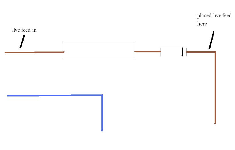

oops.jpg basically i put the live the wrong end
no luckily the unit wasnt attached at the time it just made a big pop because 2 leads where touching and then i noticed

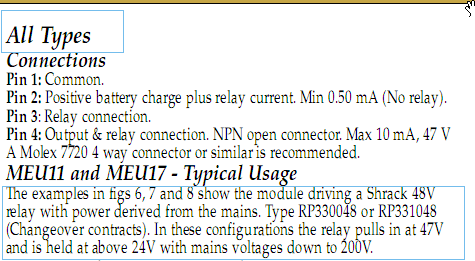

ive just realised this wont work anyway i have 22v at the unit and the timeguard person told me to use a 48v relay so 22v wouldnt be enough to pull a 48v relay would it?
Rechecked the d/s for the MEU11, it clearly states a 48V relay for Figs 6,7 & 8.
How are you measuring the voltage.?

hi all i know its an old thread now but i have a quick question about this i have 4 of the time clocks, to power the clocks like the picture could i just use 1 resistor and 1 diode and just link them through to each clock?
Sorry I don't understand what your trying to do, Could you post a better discription/diagram ?
