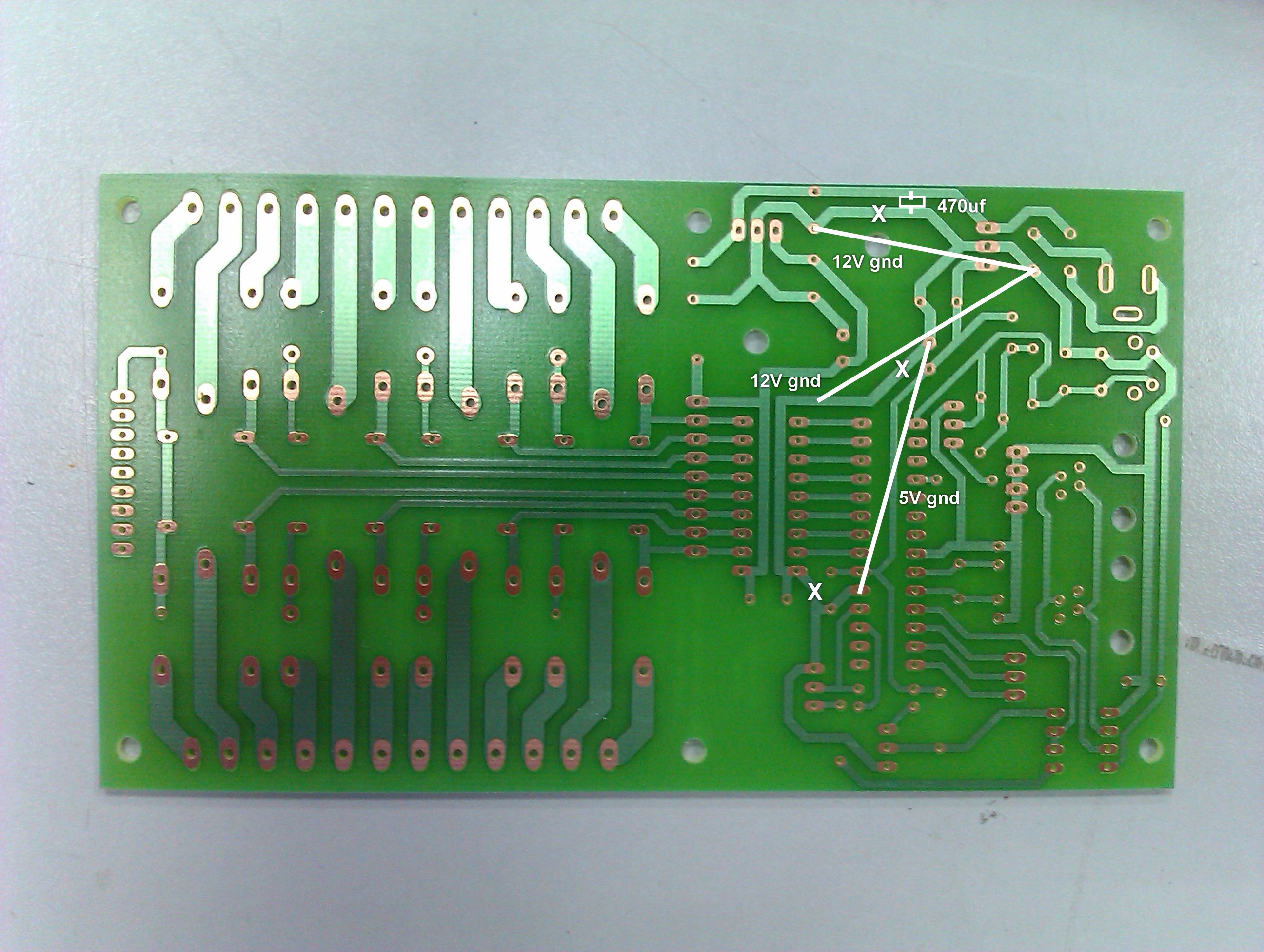

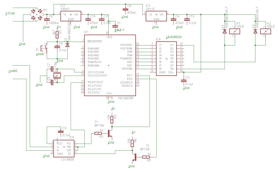

[attached is the detail drawing and the pcb layout ... ]

Your 5 and 12 volt grounding paths on the PCB from the 2803A (9) and pic (19) share a long narrow twisty path that's a prime suspect for ground bounce when the relay switches.
Yes, you have a ground loop!!! The negative power supply return net from the PIC/analog stuff should have been keep entirely separate from the negative power supply return net from the relay coils/relay driver IC. Those two separated ground trace nets should have only one cross-connection on the PCB. The only place where the two nets are tied together is at the negative terminal of C8.
I agree with nsaspook & MikeMl.
Is it possible for you to make temporary changes to the PCB to eliminate the ground loop and separate the low & high current gnd tracks as MikeMl suggested?
However, I don't see how this would cause one unit to reset another. As I wrote above, I feel there must be some coupling through the power line or the data line.

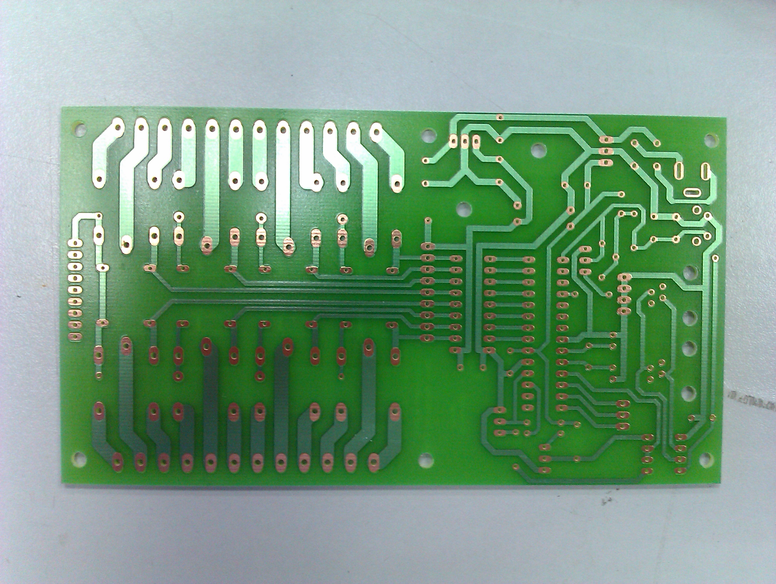

Would you think that this will be a better modification to solve my problem?
I agree that it might not be the only problem. I really don't like the design of the AC part of the relay switching, with no zero crossing or snubbing on the contacts it's a monster EMI generator that IMO should be completely separated from the controller for reliable operation with this PCB design. I would ground or set to outputs any unused pins on the uC to get a little more immunity from noise and take a hard look at the xtal circuit for dropouts during AC switching arcing.

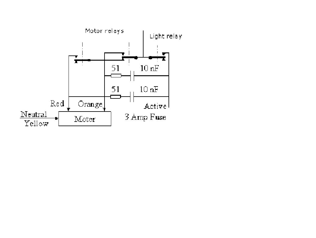

I have just completed a garage door opener controlled by a PIC.
It switches the motor on/off using relays mounted on the same PCB as the uP.
However, I connected a resistor in series with a capacitor across the relay contacts and have had no reset problems.
The values of the R & C need to be chosen according to the load characteristics.

I have attached an extract from my Garage door opener circuit for your information.
Note that the R & C values need to be selected according to the load characteristics.
