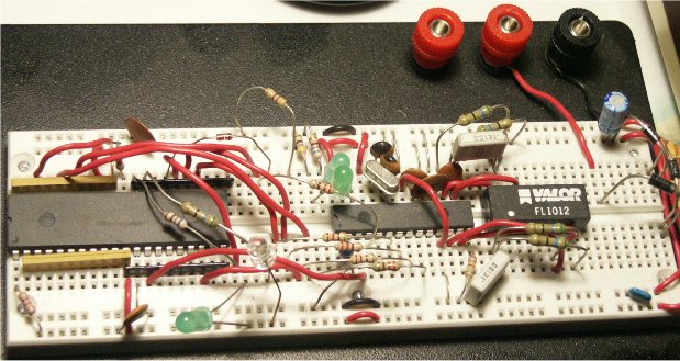

Is it possible to get a microprocessor to wake-on-lan, and then to output an HTML page ... ?
If it can't output an HTML page, then maybe it could present some temperature values, and i can insert or map them into a locally drawn page.
I want to use my downstairs desktop PC to access some sensor signals which i intend to fit up in various places on my water heating arrangements.
They would show up in various places on a sort of water-diagram.
I feel sure this sort of thing has already been addressed,
any help or advice would be welcome.

I may be misinterpreting what you need, but an 18F4620 and a ENC28J60 Ethernet chip don't need to go to sleep as they draw very little power. So little, that you won't notice the 115VAC current draw difference between the loaded and unloaded wallwart powering them! No need for an ethernet card except in the computers on your network. Below is a fully functional web page server which I built on a breadboard. You can read the ADC inputs & turn on LEDs etc, via a web browser, all with code downloaded from MicroChip. The only thing not shown in the picture is the RJ45 network plug connected to the VALOR pulse transformer:

Hi kchriste,
I don't think you are misinterpreting in any way, although you don't mention what it is you think i am looking for. I've seen other postings from folk trying to do something, in a way that is not appropriate, simply because they dont know the various ways to do what they want.
In this case, i did not know that an arrangement such as you show here in the image, could operate without an ethernet card.
In my first post i wondered if it may be possible, but i was also thinking about the wake-up, so i thought that it may as well have a card to use the wake-up.
But as you point out, the current draw is so small that it can simply be left on.
The arrangement you have shown certainly looks as though it would meet my (comparatively) simple task, namely to be accessed from my lan like an ethernet card, and present the user with an html page showing the pipework layout, and of course the sensor readings in their appropriate places on the pipework.
From your text, you say you can 'turn on LEDs etc' I dont need any control over stuff from my PC, just information from the sensors. But i am impressed that this facility is there. Maybe in the future, i might use something of it.
I am very impressed with that layout, and i want to do something similar.
Just to re-cap, will this present the user with an html page, picture of pipework, live temp readings, maybe two or more extended pages for detail ... ?
Will it be accessible via the ethernet locally, from any PC on the lan (just like normal)
How many sensors could it handle ? . For the time being i'm only thinking of four or five.
Thank you very much for the picture, and the encouragement.
John :)
Thank you. It's not an example of my tidiest work but it was quick and easy to assemble. :D
That's exactly what it does. There are about 4 small pages of HTML with simple graphics in the MicroChip example. I was able to access it with two computers at once on my network. It will bog down if too many computers try to log on to the mini web page at the same time due to limited memory and processing power. A DOS attack would only take 5 computers. :D
You can use different 18F series chips. I used the 18F4620 in a 40 pin dip with 64K of flash memory. The MicroChip example serves up 26Kb of web content, but you can add more. There are 8 analog inputs free for measuring voltages with the ADC. There are 18 pins of digital IO left over for whatever task you want to assign them.

I dont know how 26Kb works out for a web page, but it hardly sounds enough for a reasonable picture.
26Kb isn't the upper limit. It is just what was used for the demo and you could add external eeprom for more data. Attached are the files used to create the web pages. I modified them a little as an experiment when I was testing it out. It'll look a little funny in your browser because the CGI script won't be running:
