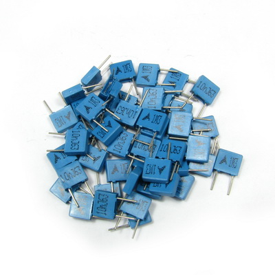

as jack asked in post #14 what is that green "thing"? What kind of capacitor is that?
Its a Mylar Capacitor.
Is it possible to filter bass using it?
Any kind of cap can be used to filter bass. as long as it is the right capacity.
The "green cap" is an Oriental metalized plastic film type which is similar to a European one that is boxed. Its value is marked "103" which is 10,000pF, 0.01uf or 10nF. Its tolerance is marked with a letter where J is 5%, K is 10% and M is 20%.
The same value for a European metalized plastic film capacitor would be marked "10n" then the same letter for the tolerance.
Since it is just a capacitor that feeds a resistor then the filter slope is a very gradual 6dB/octave.
EDIT: A metalized plastic film capacitor is not polarized.
Here is a photo of some European metalized plastic film capacitors:
