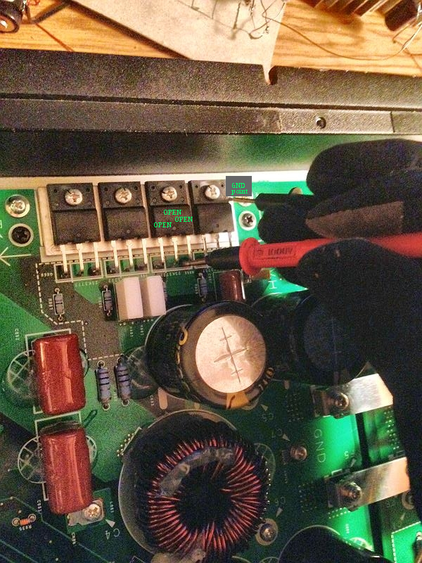

As for checking things after assembly
After assembly, the multi tool on auto range, and with no power to components being checked, place one test lead to the metal sink, then the other, check readings, should be continuity 0 Ohms confirming sink has any coatings that could interfere with testing.
Test lead (either) to heat sink, then test each transistor point looking for low value resistance, typically a low value such as 0-100 Ohms is a potential short, (the value should read infinite during testing on any pins to heat sink) thus the transistor is making direct/indirect contact to the sink, as for the correct values for that amp, I do not know them, many amps have different ranges due to the transistors used.
However the center pin on many transistors BJT and FETS alike, is the main check use for the middle pin to the sink for continuity in Ohms mode, as the buzzer type test can energize the part far more than the Ohms test mode, so avoid using the audible test methods on transistor parts.

Also if the board has charge in the caps, the readings from the multi tool will show very odd results, So since you would not likely have an method to discharge them and hold them low, you can omit the multi tool test for the three lead check.

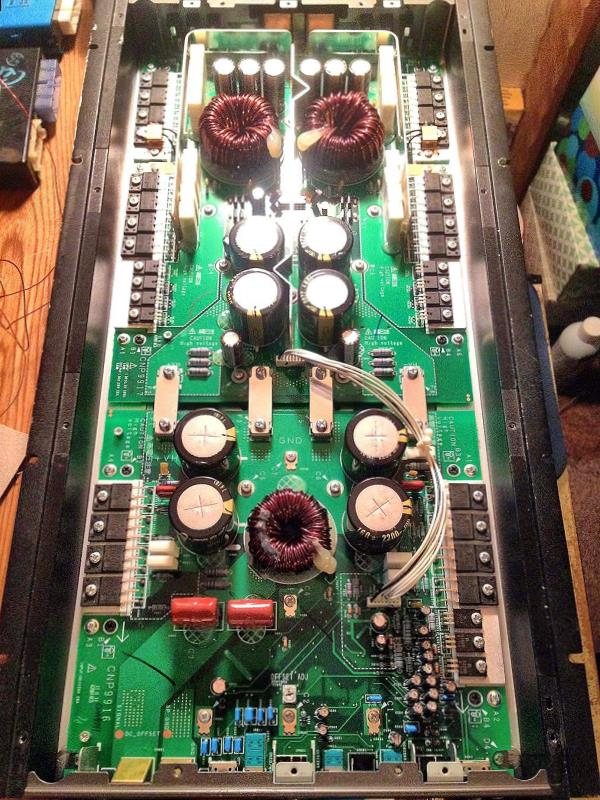

This amp is a Class D hyper, with dual power banks, one for the positive rail and the other negative.
Your amp can have different results on the three pins to heat sink. However should NOT read zero Ohm continuity, they should read infinite. Any questions please ask.

Grease on the sink to chassis, that sounds a method to help prevent the housing from becoming live if a short, or only one transistor makes contact to the sink and transfers its energy. Similar to the cap of death for older auto transformed guitar amps. Note that the power from the transistor is high, tho not connected to the main power in from the mains as the death cap is on old guitar amps.
Also if 3 pins are tested and any start to climb in reading, That;s a charging effect to a cap as the parts are connected to the board and surrounding components. That's an ok result. Again, just no continuity as example if both test leads were crossed.

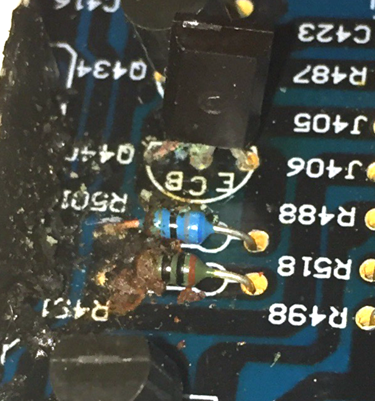

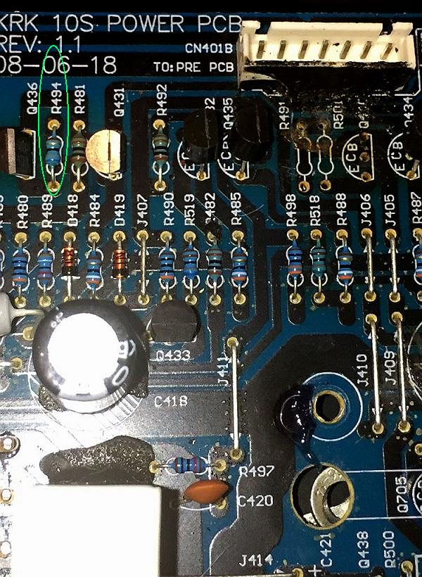

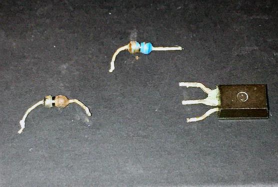

Just need to check up on verifying the parts, The blue resistor is bugging me. If it has Blue, Grey, black, Gold, Brown. then it is a 68 Ohm.
However, if it has Blue, Grey, Black, Brown, Brown, then it is a 6.8 Kilo ohm. The images I've seen show it to be a 68 Ohm. However I can only enhance the image so far. The pull down resistor is usually low, As to following the tracks on the board, the corroded transistor is responsible for operating the switching control transistors for the main drivers. This is being noticed only recent (the resistor).
