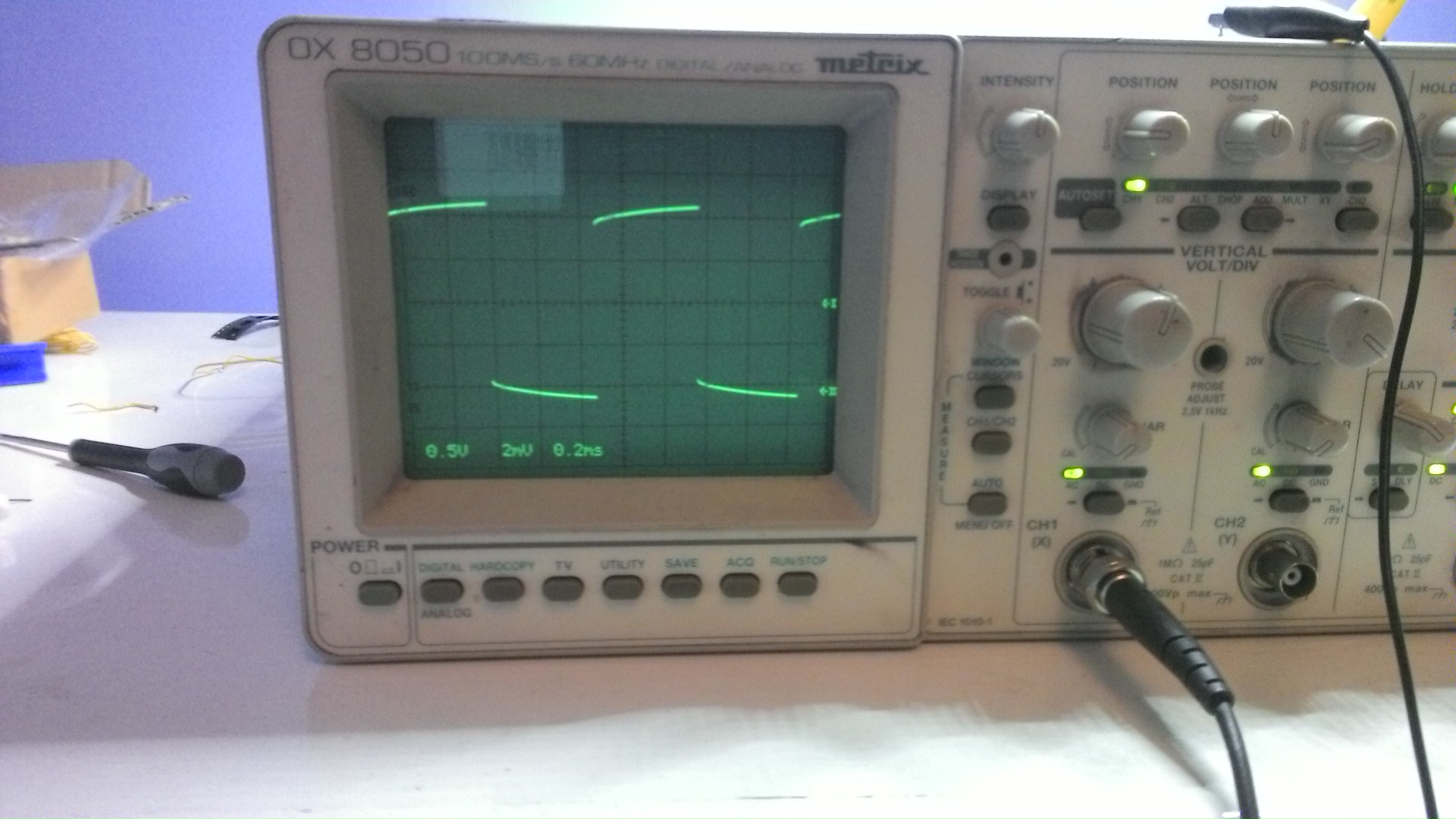

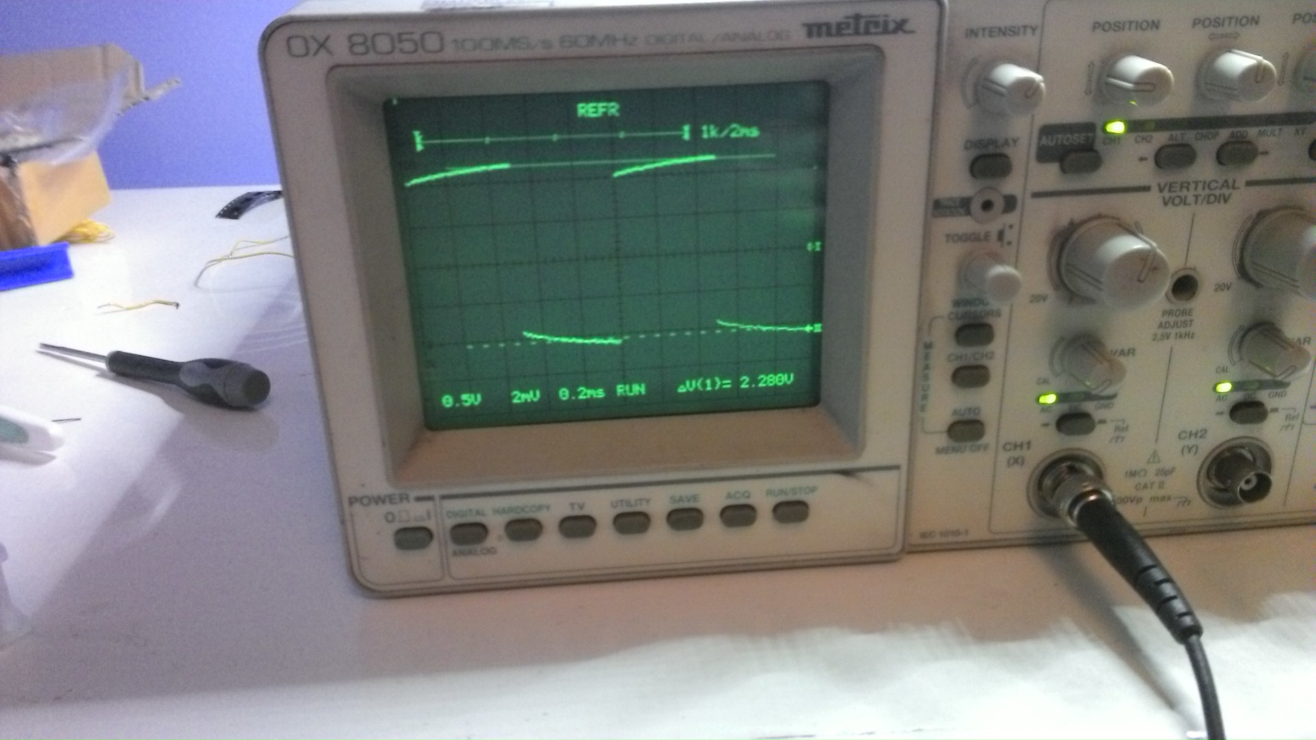

It works in a fasion!! It has a little curve on the peaks of the digital probe test signal that my other scope doesn't pick up so I'm guessing on another cap gone down in the input section? It does it on both channels though which points to something more generic! See what y think!
I should also add that this doesn't change when you change the channel to DC seen as my pic had it still set to AC!!

It works! Excellent news. I suspect the rounded peaks are simply because the scope probe needs to be calibrated to the scope. i.e. push the end of the scope probe in to the hole marked "Probe Adjust" on the front of the scope, and adjust the trimmer on the probe (either on the BNC body or on the tip body, depending on the probe type) for best results. Probes from one scope don't always work well on another without adjustment.
For comparison, here is a picture of my OX 803B screen just after I fixed it, and pre-calibration.
If that is the issue, then just get some new probes, calibrate them and leave them attached to the scope (check them every so often depending on how much use the scope gets, to ensure they haven't drifted off).
Oh.. and give the case and the buttons a treat...
(Other cleaning products are available. :))

By the way just had a go with the probe adjust but it isn't the problem entirely it was a little out since I last did it on my other scope however the lines still aren't perfectly horizontal they are continuously concaved front down, back up! They are perfectly straight now but still on the pss! Tom

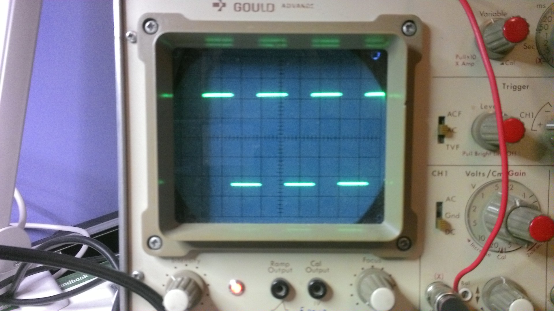

I would still go for the probes as the most likely source of the non linear square waves, since they are from a different scope and they may not match particularly well. If I am correct in my identification, your other scope is a Gould OS 250, which is only a 10 MHz scope, so the probes for that may not be very well matched to the OX 8050.
If you don't mind the wait, those **broken link removed** seem reasonably good although you might have a bit of a delay while they ship from China.
Certainly for the price they make a good spare, for when the inevitable happens and you break a probe. They claim to be good for 100 MHz so they should work fine on your 8050. But reading the small print, it is likely that 100 MHz is only available on x 10 mode (better response on x 10 is usually the case, unless you spend $100+ on a probe), the x 1 response is probably lower, perhaps as low as 6MHz. Spec. of the probes I linked is below.

Definitely good enough for most things, and certainly good enough for audio work and low end microcontrollers. The response doesn't drop off a cliff at 6MHz on x 1, but becomes progressively poorer and using the x 10 attenuation mode with them on your OX 8050 should still allows you to fill the screen with a +5v signal at 60MHz. In the unlikely event that one of those probes also shows a problem, then we need to look at the set up of the front end.
That would be a learning experience for both of us, since we don't have a service manual. Don't go fiddling with the trimmers on the front end until we are certain we have a problem though. It can be a bit of a nightmare getting things working accurately again after someone has been for a random twiddle.

Of particular interest is Figure 3 - the diagram shows the multiple square waves obtained by trimming a scope probe, overlaid one on top of the other. You can see the effect of over and under compensation (the rounded shoulder you are seeing versus the spike and dip of over compensation). Your dual Analog/Digital scope will give you an insight in to the value and limitations of both types of scope. If you ever see another one of those OX 8050's going cheap let me know, it looks like a very useful tool.

Hi sorry I've been a little quiet lately but I'm working away from home at minute! As soon as I get back I will follow up our previous works! What I can say is that before I went away I tried adjusting the probe to the test signal and it got rid of the kick in the signal but the digital wave is still concaved! More pics to come soon when I get home!! Cheers Tom
Do you have access to any other (higher bandwidth) probes, I'm still convinced this is caused by the probe, and not the scope.
I agree, the first order problem is to match the probes t the scope. 1 M || 20 pf for an input Z is pretty typical. Probe bandwidth has to be = or greater than the scope. There are some probes that are non-standard. Don't get 50 ohm probes, for instance.
