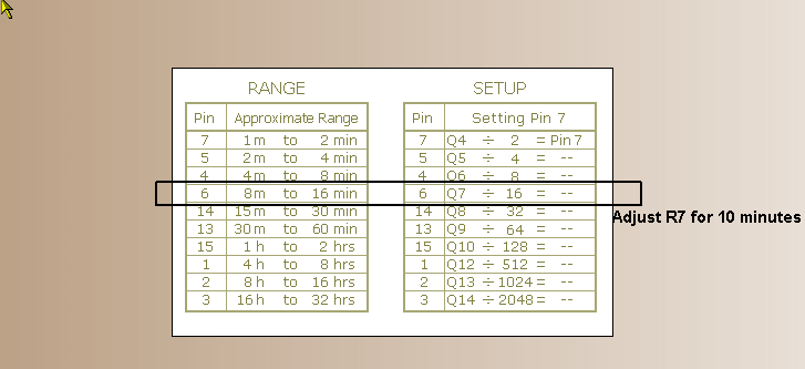

Friends I want to know what is the formula of time in ic 4060.
And if I want to repeat timer in 10 minutes, what value of resistance and capacitor will i put in this project. And how to remove all required values from formula?

hi yusuf,
All the values are on that web link circuit.
The 4046 Fosc = 1/[2.3*[R6+R7]*C4]

R8 and R7 are connected in series, so the maximum value would be 370K ohms. The capacitor C4 is 10uF.
So Freq = 1 /[2.3 * 370k * 10uF] which is 0.117Hz
Use the variable resistor R7 to adjust the frequency.
The 4060 is a 14 stage binary divider, so by tapping off at the various output pins it will give the required high at the output times

to make the time periods shorter , lower the value of the 10uF [C4]
Friend If I want 10 minutes timer then what changes i'll have to do ?

R7 is a 220K variable resistor, turn the adjustment screw to make the R7 value lower, I would guess approx 100K should give 10 minutes.
You will have to make small adjustments until you get exactly 10 minutes
