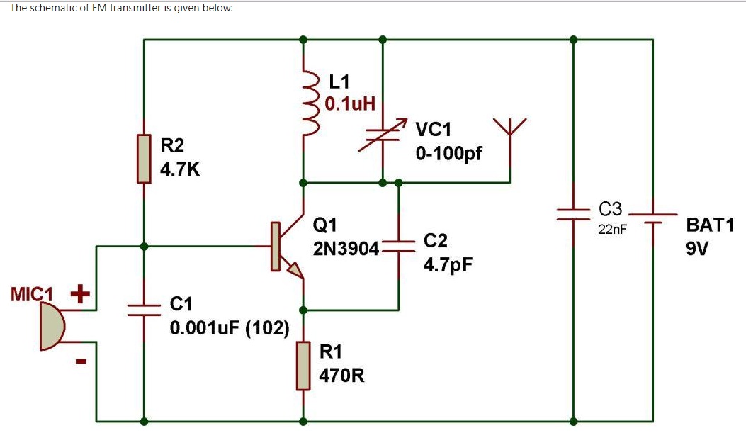

ok well i was thinking about building these 2 projects, and maybe so other low power transmitters at some point, mostly from designs on this site i think,
and it would be nice if i knew how to sub the mics for in lines myself, rather then having to ask here every time i build something. so if you guys have any ideas please assist.

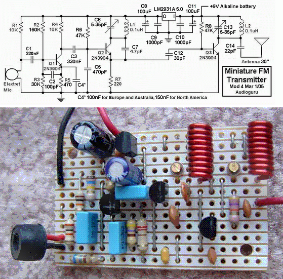

ok, well how would i do that? what do i need to change in the diagram?i mean i mostly just need to know componet values and placement of the new parts
and can ypu recomend any other transmitter circuits to a kinda beginer such as myself?
You can make my fixed and improved FM transmitter if you want:

i almost forgot, so what can i do to learn how to substune microphones for lines in on variuos trnsmitter disigns?
Do you want to substitute line-level signals for the microphone level signals?
Then simply remove the resistor that powers the microphone and add an attenuator made with 2 or 3 resistors. Use 3 resistors to mix left and right stereo channels and attenuate.
that would be the r1 resistor right?
also what kind of a componet is LM2931A 5.0? i'm not familiar with it
Yes, remove R1 and make a passive mixer/attenuator with 3 resistors.
The LM2931A 5.0 is a low-dropout 5V regulator that still regulates perfectly when the 9V battery voltage has dropped to 5.5V. An ordinary 7805 regulator fails to regulate when the battery drops to less than 8V. The battery voltage quickly drops to less than 7V. The transmitter's frequency changes if the 5V changes.

all semiconductor IC manufacturers make 5V low-dropout voltage regulators. the LM2931 is made by National Semi and they make many different ones.
Try this for a mixer/attenuator:

can i use your attenuater circuit with my fm transmitter that i mentioned and will this fm transmitter will work plz reply soon thanks.
