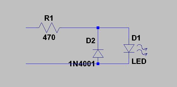

if you want it to last (maybe even longer than the rest of the radio) replace it with a white LED a 1n4004 diode and a 470 ohm resistor. since it's being fed AC voltage, polarity doesn't matter.
If I remember correctly they use a pea lamp (6v0. These are hard to replace the LED seems an Ideal solution
