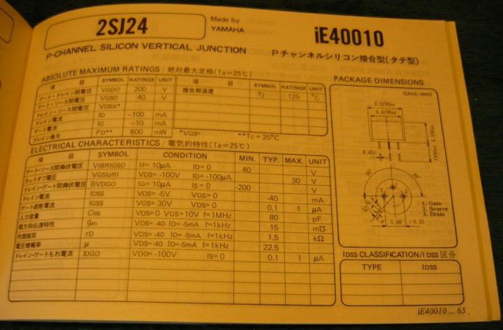

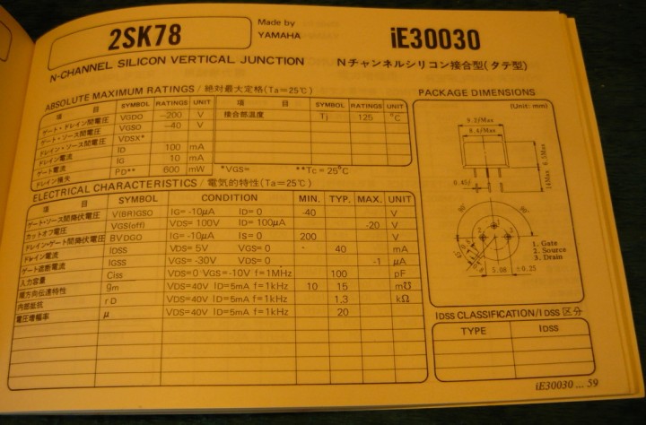

I'm having the hardest time finding a proper match for 2SK78C transistor that fried on a Yamaha C1 pre amp.
The one shown on the attached picture.
Did you end up finding a good replacement for this one?
Thank you for any help you could bring!!
Greetings from France!!
I happened to be involved with Yamaha Audio at the time ...
2SK78/2SJ24 were made by Yamaha utilizing the SVJ technology and were exclusive to some of the their Home Audio products during the "low noise" contest era.:rolleyes:
There were couple of packages(T092, T05) along with A/B/C suffixes which mainly changed the power dissipation.
View attachment 133982View attachment 133983
what do you think about the idea of replacing those devices with depletion mode MOSFETs?
