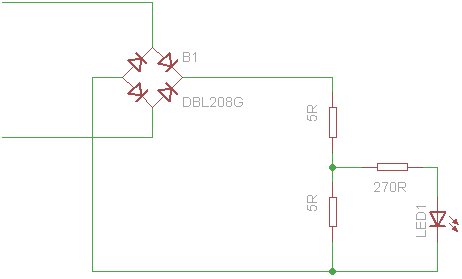

Hi Duffy, thanks for the reply and the clear connection description that you gave. However, I looked into alternator theory prior to my original post, and probably the best source I found was here:
Understanding Alternators, How alternators work
This seems to support what I already believed to be the case: specifically, removing the filament lamp will, in many situations, prevent charging because the field coils don't get enough excitation current. Indeed, in my own experience, this has been the cause of a problem - that is to say I have owned vehicles that stopped charging the battery when this bulb has blown.
Now, I know that modern alternators may behave differently as they are 'self exciting'. Also there are many so-called 'one wire' alternators that operate in a different manner yet again. But it seems to me that there are still going to be some that will misbehave and I'm trying to cover all my bases, as it were.
So I believe I am still looking for a solution. I have theorised that I could replace the bulb with a bridge rectifier; the opposite side of the bridge could have a resistor potential divider across the bottom end of which one could put the LED. This would draw (pass) the required amount of current to ensure the alternator field coils are excited but would (should..?) also light the LED irrespective of the voltage polarity. I've attached a scematic of this idea and I'm open to all comments! What I typically find is that although I initially believe these schematics to be correct, there is something crucial that I have missed, which causes it to fail or misbehave....

That circuit looks fine to me. It will present a 10Ω resistance in place of the bulb, rectify the voltage so the LED never gets a reverse voltage, and has a limiting resistor sized for a good 15ma or so of LED current.

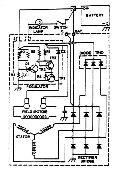

I looked up the operation of a typical alternator and the circuitry does not need a bulb with any specific resistance. If voltage drops out from the diode trio that powers the regulator, the bulb just turns on.
BUT ALSO if the battery voltage drops lower than the alternator output because of a battery fault! I think behaviour depends entirely on the type of alternator...
That's what I thought. Turns out the bulb provides excitation current to the field from the battery. There's no permanent magnets in an alternator.

Obviously there may be some fine tuning to do. It's been suggested that the bridge is not required; but if it's not there, how can the potential be normalised, bearing in mind that it MUST be since the LED is a unidirectional device, and current may flow in either direction?
Carlos, your circuit will enable the light to be plugged in either way, no fooling with a voltmeter necessary. Your original circuit was the right circuit. I shouldn't have suggested otherwise.
