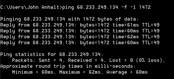

Following MS's and Netgear instructions, I find that my MTU's should be set at 1500, and when I ping ETO at 68.233.249.134 with 1500 bytes, I get the "packet needs to be fragmented but DF set" error. Ping with 1492 gives the same error, but 1472 (1500 -28 per MS) comes back. I neglected to write down the times.
So, is ETO set at 1472, or is there some setting in my system that I am not finding?
John
Edit:
Here are the ping results:

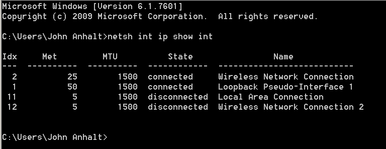

And just FYI, here are the network MTU settings. I don't understand the LAN response, but everything, except ETO, seems to work OK, including a wireless printer.
If you're not running your own email server then you shouldn't need to do anything with the MTU on your router or computer.

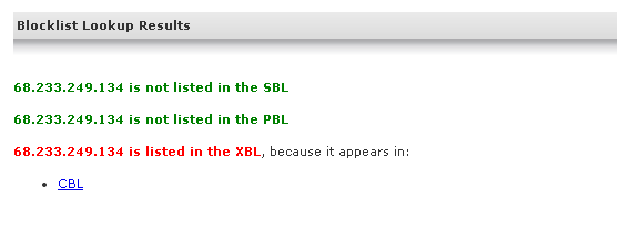

Just heard from Armstrong. It uses Spamhaus.org, and 68.233...is listed:
Maybe a solution is near? According to the tech service person, getting off the list will require an action by EM.
If this solves the problem, maybe weekly maintenance (or more frequently) should include checking blacklist providers.
John
Here's an update. Apparently it is been removed from the CBL list:
ETO was also listed on spamcop.net and will be de-listed in about 19 hours, according to that site.
