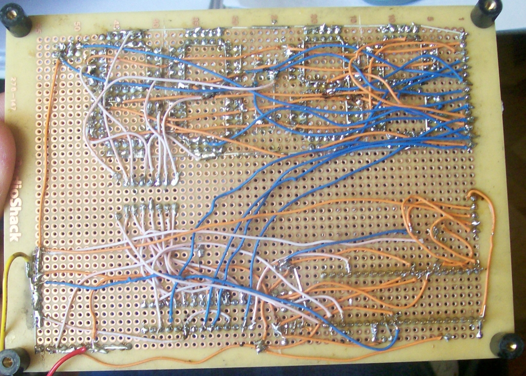

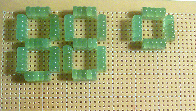

Have a look at me 7 SEG 4 digit (not done yet)
7seg-jpg.23039
7seg2-jpg.23040

series would suck for this. If 1 led went out the whole segment would not work. Hence the parallel.
If you consider that a problem (which it shouldn't be, as wired in series the LED's would be reliable), then put them in parallel, but with an individual series resistor on each one - doing it like you've done it so far will drastically shorten the life of the LED's.
I wish i knew that before i built this. But Im sure it wont make too much of a hassle. Next time ill be sure to make some 5x7 matrix for a clock :D
