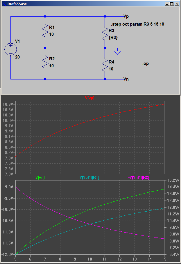

Is this what you were asking about?
R1 and R2 are the splitter resistors. R3 and R4 are the loads. R3 varies from 5Ω to 15Ω (x-axis of the plots). V(vp) shows what happens to Vp while V(vn) shows what happens to Vn. Note that Vp-Vn is exactly 20V (V1).
The blue and violet plots show the power dissipation in R1 and R2 respectively as R3 varies.
Notice the outputs are truely split only when R3 = R4 = 10Ω. (Note that R1=R2=10Ω, not 4700Ω like in your original posting)
Regulation is piss poor. Power lost in R1 and R2 is very high; all in all a terrible way to split a power supply.

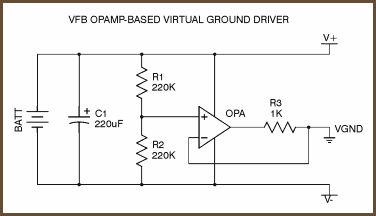

I suppose the next step up from resistors and caps is as per this uploaded diagram with a high power op amp like an LM675 to deliver the 1A required.

Why do you need a high power virtual ground? Do you feed plus and minus DC to something?
I made many AC opamp and power amp circuits with ICs that need a positive and negative supply but I used a single positive supply and biased the opamp inputs at half the supply voltage. The inputs that are biased use a tiny current of only 0.1uA for an oPA2134 opamp or 0.2nA for a TL072. Then the bias resistors are usually 100k ohms. The input and output have coupling capacitors. If there is a negative feedback resistor to ground then it has a series capacitor.

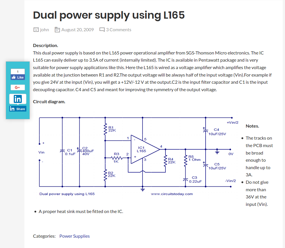

Do I assume correctly that less current will be lost with the op amp splitter than if I just use resistors and caps alone as in my OP?
Can this difference be quantified?
Yes, the current will likely be less with the op amp.
The difference is the current through the resistors versus the current required by the op amp (from the spec sheet) plus the current through R1 and R2 in the op amp circuit.
