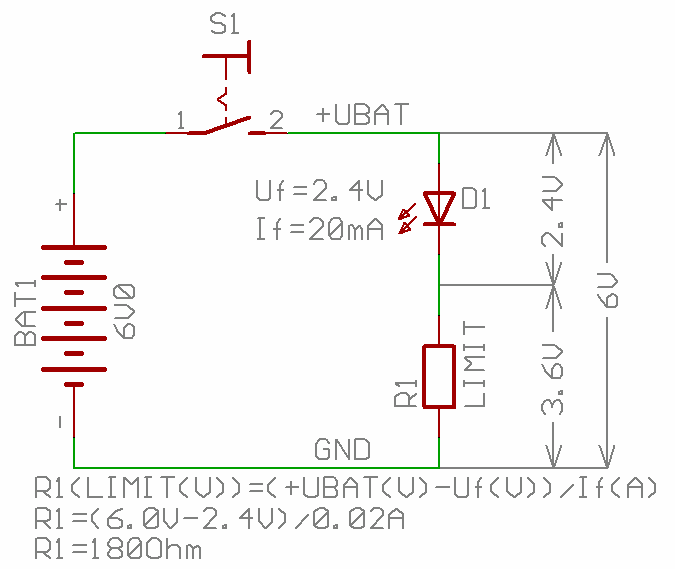

Hi limlik,
may be you can use this little schematic for better understanding.
If the calculated resistor value is not a standard value, e.g. 170Ω, use the next higher standard value (180Ω) - never a lower one!
Boncuk
Always use the nominal voltage drop, not the maximum voltage drop and use the recommended operating current not the absolute maximum.
Round the resistor up to the next preferred value not down, especially if you're using a current close to the maximum. For example, if you calculate 50R, use 56R rather than 47R.
