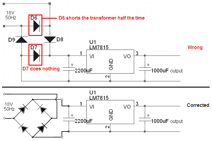

You have two of the rectifier diodes connected wrong:
Are you sure your bridge is connected like that? If it is, D6 is toast.
Sorry I mis drew it.
I showed the bridged by 4 diodes In relaity I have used a pole diode (those that 4 diodes are in a pack).]

Having a bridge rectifier in a package does not prevent one from connecting it incorrectly. If it is connected the way you drew it, you will have a half wave rectifier (and possibly a burned out diode), which could be the source of your hum.
Is the transformer rated at 18V RMS?
Are you able to measure the DC voltage at the input to the regulator?
Do you have an oscilloscope?
If so, observe the input and the output of the regulator, and tell us, or post a picture, of what you see.

No, I am SURE that I have put the bridge rectifier correctely. It ha signs that show th pins for AC input and signs that show th positive, negative output.

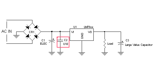

The 2200uF cap at the input of the 7815 gets hot, the rectifier package gets hot too. Is this natural?
Now the circuit draws more than 1A at some situations. I fear to lose my 7815? The 7815 gets too hot too while it has a 40mm x 20mm radiator. Now after 15minuts of working the circuit turns of by itself. I think the reason is due to the regulator. What’s the solution? Is a higher radiator helpful while the circuit draws more than 1100mA at some situations?
Somewhere I read that it is necessary to put the C2 (see the bellow pic) which is a 0.1uf at the input of the regulator to prevent oscillation and help the regulator chip to not get so hot.
I am wondering while the capacitance of C2 and C1 (which is 2200uF for my circuit) is added (they are in parallel) how it does help to prevent oscillations?
Can I use another 8718 or maybe 7820 before my regulator chip to feed it just with 18V to 20V rather than 24v to prevent overheating?
Can I achieve more than 1A at this situation?
