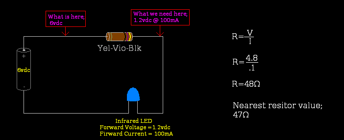

Apart from your maths being a bit off:eek: you are on the wrong track with the LED.
LEDs (and ordinary diodes, transistors etc) do not obey Ohms Law.
What the data on the pack is telling you is that when there is 100mA flowing through the diode, there will be 1.2volts across the diode.
But if we turn the current down to 50mA, there will still be (guess) 1.1volts across the LED, not 0.6 volts as Ohms Law would predict.
When the voltage across the diode gets down to (another guess) 1.0volts there will be no current flowing through the diode.
If you want to operate that LED from a 6volt supply, you must connect a resistor in series with the LED before you connect them across the supply.
OK so what value of resistor?
The supply is 6volts, the LED wants 1.2volts, so that leaves 4.8volts across the resistor. We want 100mA to flow through the diode (and the resistor because they are in series), so lets use Ohms Law.
R = V/I = 4.8/0.1 = 48ohm.
Also consider the power dissipated by the resistor.
Various ways to calculate this, I will use
W = I x I x R =0.1 x 0.1 x 48 = 0.48 watts. So a 0.5 watt resistor will do (just).
Problem, 48ohm resistors are hard to find, 48 is not a "preferred value". I practice we would probably use a 47ohm resistor which is a preferred value.
Caution, the ratings for the LED as printed on the packet, are they "normal working" values or "absolute maximum" values? If you want equipment to have a long and happy life, you dont run it at the maximum ratings.
If 100mA is the maximum value of current through the LED, we would design for a working current of 50 to 75mA. To do this we would need a different value of resistor.
A calculation for you I think.
For the last time, i am 100% sure that these are the ideal/normal/recomended characteristics. Yes, i know my math was off. I didn't quite know what 100mA equals in amps. I know now that it is .1.
Is this right? I just drew it quick. Thanks.
circuit-png.8931

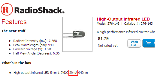

This is the only IR LED on RadioShack's website. It is rated at 29mA which might be its max continuous. 100mA would smoke it.

Here is what it says on the back of the package;
Electrical Characteristics (25°C)
->Radiant power output (100mA): 16mW min.
->Forward voltage...................: 1.2V
->Forward current...................: 100mA
->Viewing angle to ½ intensity...: 45°
Absolute maximum ratings (25°C)
->Foward voltage (20mA)..........: 1.6V
->Reverse voltage...................: 5v
->Forward current...................: 1.2A
->Reverse current....................: 10µA
->Wavelength.........................: 940nm
See how long it lasts (or how quickly it fails) if you feed it its max of 100mA.
I'm not being a smart ass. I want to know what i am doing wrong. What should i be looking for? If you would like, i will take a picture of the back, and then you can tell me what i should be looking at. Why does it say "Forward voltage: 100mA" under "Electrical characteristics"?
No. It says, "Forward Current= 100mA but only if the ambient temperature is 25 degrees C or less.
100mA at 1.2V is 120mW which is a lot of power for a little plastic-cased LED. 120mW will make it get hot inside. If the LED is mounted without free air flow or is used in summer then it will be in an ambient temp that is more than 25 degrees C and won't be able to dissipate 120mW so its current must be reduced.
Yes, but isn't 25°C room tempurature? So then it should run at 100mA? What would you suggest running it at? And why would you run it at that? Please bear with me, i am still trying real hard to understand.
The listed forward current is the maximum (EDIT: *CONTINOUS*)allowable forward current, and you want to stay under the max, so try not to run it at 100mA. Run it at less than that depending on how bright you want it, and the hotter the ambient temperature is, the lower this maximum is. So that's another reason to run it at under 100mA.
