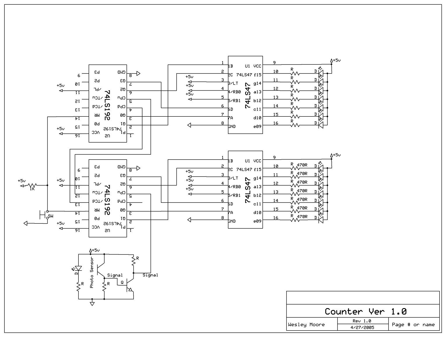

I've built a basic counter module with 3 LED displays, It works, but I have coupled it to a photo interrupter so that i can count revolutions. Now it seems to jump 5 to 10 places per revolution. I'm guessing there must be spikes in the signal coming from the photo interrupter. Does anyone have any suggestions to making this more stable?

A schematic diagram of your circuit would help us to help you ...

Here is a basic schematic of the system.

I suggest you insert a low pass filter followed by a Schmitt Trigger IC such as the 74LS14 in the signal line.
I''ll try to draw a diagram
Collector of NPN transistor------resistor-----A-----Schmitt Trigger-------> U2/5
Connect the capacitor from A to gnd.
