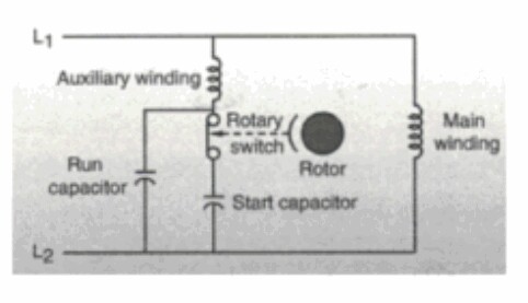

Update on Reversing AC Motor
Hi Again Everyone. Tnx for the replys to my post but since posting I have run across this small picture that might make it a little clearer for everyone.
I want to cut the Aux winding loose from L1, cut the capacitors loose from L2 and then flop everything upside down and rewire. My question is and still remains, will this start the motor in reverse direction. The phase shift will be changed across the stator due to the L C network being upside down? Thanks for your help.

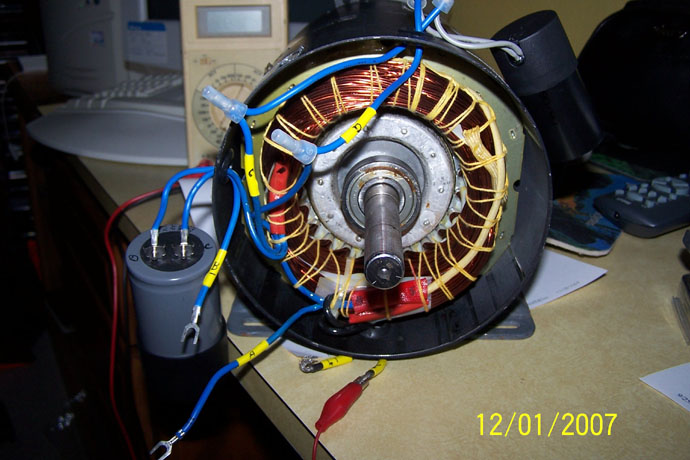

Hi Nigel and tnx again. It's not that I haven't paid any attention to your replys - I have and do agree with you on the solution but to explain why I haven't yet done that, look here at the attached photo. It's a new motor ($260.00) with NO terminal board with wire terminations on it. If I smoke it, my brother would not be too happy. I would have to cut open butt splices, tie strings and pull wires from varnish, I've been down that road before and it's a rough one to trave. Anyhow, I'm reluctant to do that. I think I'll suggest he buy the right motor or stick it out the other side of his bandsaw, Hi. 73's and tnx again.

I can see one big capacitor in your photo. Where is the other one?
I see what you mean about modifying that motor, but you might be able to cut the wires and use connector blocks while leaving the splices alone. If you label the wires, use connector blocks and is doesn't work, you can just go back to what it is now.
Hello Diver300 - Tnx for the reply. The second Cap is hanging from motor at top right of motor (still in Black covering). I have not tried spinning the motor as to reassemble it all includes putting the switch, Mechanical Fan and end plates all back together. Still hoping for something easier. Thanks again
Howdy again,
If you remove the three connections you mention, and then flop *everything* upside down, you're back where you started. But if you remove the three connections you mention, and then flop L1 and L2 with accompanying main winding upside down only, then you're okay. (Communicating is so wonderful.)
But, the right thing to do here is to just swap the wires to the main winding (two disconnections vs. three). That's what you want to do, and leave everything else alone, and the motor will rotate in the opposite direction.
(Also, according to the diagram you supplied, the start capacitor is simply added to the run cap at start time, then pulled out. It's making the phase shift bigger for a short time to get it to start. This is a variation of the PSC motor [permanent split capacitor], called a two capacitor start/one capacitor run motor.)
Corey

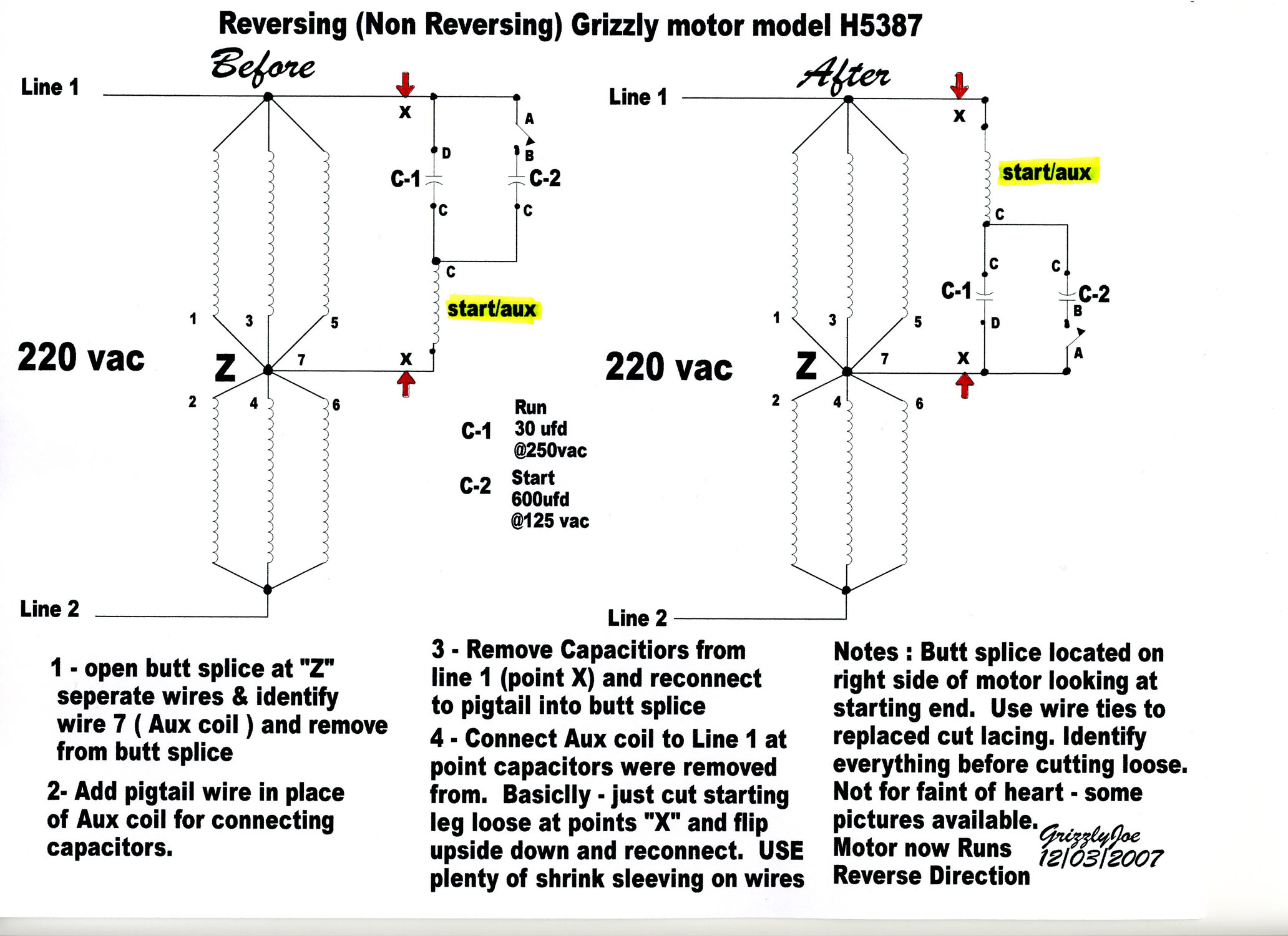

The End of Story
Hello again everyone and thanks for all the input, it was appreciated. I finally bit the bullet and tore everything apart and numbered all the loose ends, then drew up a motor schematic so I would know where everything went. After seeing all of the wiring for this 220 volt motor and the connections, I went ahead and flipped the starting circuits and rewired everything. Used plenty of heat shrink and lots of wire ties (tie wraps?). Crossed my fingers and fired it up - no smoke and it was running in Reverse now. I have to admit that I took plenty of time and triple checked everything. Once again I would like to thank all who volunteered help. I have attached a schematic if anyone would care to see it. Tnx & 73's Joe

GrizzlyJoe said:
Crossed my fingers and fired it up - no smoke and it was running in Reverse now. Once again I would like to thank all who volunteered help.
Cool man,
Corey
