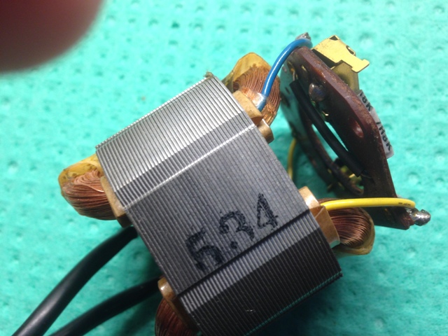

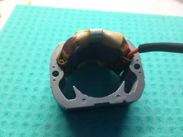

I've now discovered that one side of the motor stator coil is fractured .. .. .. when I removed the commutator I found a small piece of spring steel embedded in one of the stator coils, cutting through several winding strands.
I've removed the coil, counted the windings, measured the wire .. .. .. but ..
Do you think to rewind the coil is a realistic undertaking for a novice - I've never done one before ... or should I try and get it done by a professional ?
I've never done it, but it looks fairly straightforward, make a template to wind the wire round, then transfer it to the motor.
I'm sure there are a number of people on here who have done such things, and can better advise.
First off, based on the building skills you have shown so far, I think you could rewind the motor and get it to function. Your winding may not be as dense as the original. Also, many (maybe almost all) commercial windings are infused with a "varnish". Getting it rewound professionally in the US would probably be cost prohibitive -- I once checked into that cost for a fractional hp British motor, and it was far cheaper to buy a new one and make it fit.

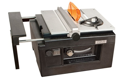

You don't mention the model number of your Proxxon. I have a MicroMark table saw that is like this and have used it to cut PCB's:
With a carbide blade, it works but is not pleasant to use. I do not like being bombarded with little chips of flying copper and PCB. Also, it is quite difficult to get a truly square cut. The PCB will tend to walk on you just a little bit. I currently use a cheap ($25) tile cutter from HomeDepot.
If size is critical, I use a disk sander for that final shape. Cutouts are hard to make either way. There are ways to do that, but that discussion would be way OT.

The Proxxon is an KS 230
It is quite small, 10 inch x 8 inch x 3 inch - uses a 53mm blade and has a suction port for a vacuum on the rear.

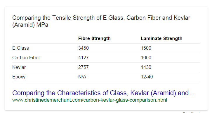

The band saw will work, but only for a very short time. FR4 PCB will dull HSS very quickly. Glass fibers have very high tensile strength:
For comparison, here is a quick link to Wikipedia showing tensile strengths of steels: https://en.wikipedia.org/wiki/Ultimate_tensile_strength There are probably better resources, but the message is still the same. FR4 PCB's will dull ordinary steel and even HSS. Why does a shear work? The shearing action doesn't require a particularly sharp blade; although, the edge can't be too round. Carbide holds up better, but carbide band saw blades are expensive.
CNC or ordinary routers with carbide bits work, but that is also a different process.

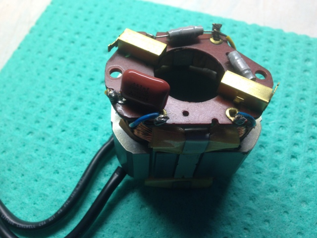

Yes .. 0.25mm wire; 350 turns; didn't clock the direction of winding but I can pick that up easily enough. I've made a balsa wood former close to the exact size and shape of the old coil which is in 3 pieces, so that once wound, if I remove the middle piece the two pieces in contact with the coil should fall away .. .. .. at least, that's the theory/plan.
There is a small board on the top of the stator holding brushes, coil connections and a good size MKT capacitor, see pic .. .. .. .
