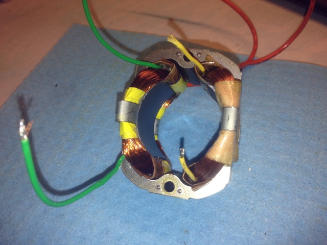

A bit of an update on the motor rewind ... .. .. ..
Yesterday, I managed to get the leads soldered and insulated for the winding ends and then wrapped and refitted the coil to the stator. I had some difficulty getting the coil to maintain the shape required to clear the commutator but the coil eventually decided that of the two of us I was the more stubborn, and I then got to soak the new half of the stator in a plastic tray full of air drying xylene varnish. After an hour or so, I removed the coil from the tray and suspended it to drain off and drip dry overnight.
Today, I re-assembled the motor and plugged it in .. .. to my amazement it didn't explode, but it didn't turn either, just emitted a very loud hum. I reversed the brush connections on the new coil, re-assembled and it all leapt into life.
I've now re-assembled the machine and it all works, including the speed control, which my tacho measures between 3500 and 8000 rpm.
As Hannibal once said ' I love it when a plan comes together ! ' I'm chuffed to bits at having achieved this repair ... .. Thanks for all your help.

Can you draw an arrow to the side you made? Otherwise it is impossible to evaluate the quality of your work. ;)
Well done.
John
Congratulations, it sounds like you had the field polarity both connected for the same pole, we used to power the windings with low voltage DC and confirm the polarity with a compass.

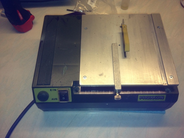

Hi Guys
I wanted to round off this thread with a little information some members might find useful.
It was always my intention to use this circular saw for PCB cutting to size. It is very small .. .. 240mm x 200mm and uses 50mm blades which are available in a variety of metals and tpi's. I was, however a bit concerned when some members voiced concern over 'flying swarf ' when cutting PCB's.
I waited to be sure of a successful repair before buying a 24 tpi, Tungsten Carbide blade which arrived yesterday and was fitted to the saw last night.
I have to report a fine, clean cut and the debris is mostly fine dust that collects in the dust trap, under the blade quite nicely. Of course, there is a possible health risk related to inhaling the FR 4 dust, so a face mask in addition to the obligatory safety spec's is essential equipment, but on the whole the results are great.
