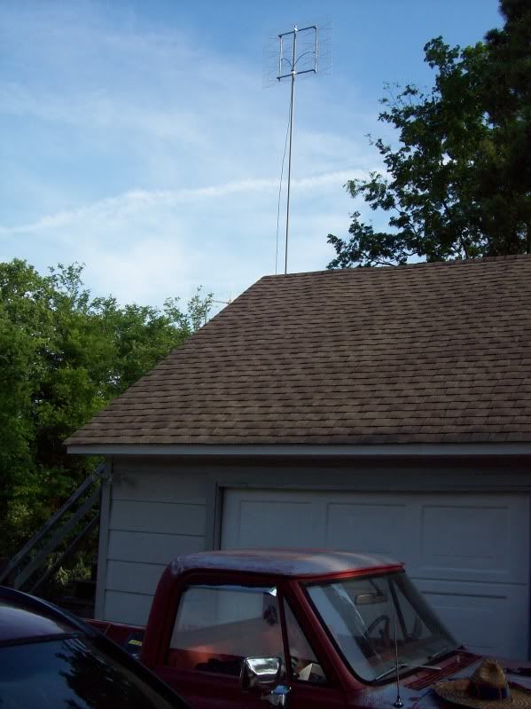

The 8200U antenna fell, so it's not up there yet. For the time, it was up there, it did pretty well. The current hodge podge is pointing into a huge tree. I have to finish coming up with the guy wire/turn buckles and make some stud changes to get the support bearing to work and enlist the help of a friend.

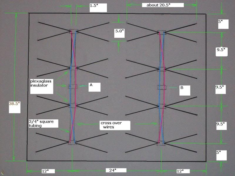

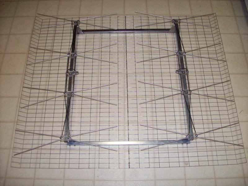

Finally I put my antenna outside on a 20 ft tower made from two 10 ft sections of chain link fence rail. My stations are all between 295 and 321 degrees magnet. My antenna isset at 308 it picks up 13 degrees both sides of center. I can pick up most of the stations with a tiny antenna but I get a lot of fade, I loose all the channels for 45 minutes with the sun on on the horizon, no TV at all during a hard rain or snow or high wind. A 4 bay bow tie antenna worked great 98% of the time and picks up all channels 40 miles away but no signal during a very hard rain. Next I put up an 8 bay bow tie antenna now I pick up all channels even during a hard rain. 8 bay is over kill but is solved the rain problem. I put up a second antenna for another TV located in the bedroom. I am picking up 44 channels 8 movie channels, weather channel, NPT and more. It is great. If you buy an 8 bay bow tie antenna like the Channel Master 4228 on ebay for $65 you will need to make a few changes for it to work the best it can work. The cross over wires need to be at least 1" apart. Buy some fence wire to make a 48"x48" reflector screen for the back reception will double. Buy 5 antenna matching transformers try them all ONE will work better than any of the other 4. Swat the wires on the antenna machine transformers one way always works better than the other way. Use one section of coax with no splices. If your antenna is 150 ft from the TV one 150 ft long coax works better than two 75 ft coax wires connected together. I built my own antennas I was selling the plans on ebay for a while.

There were two antenna locations on the house. Both were eve mounts on the sides of the house. One eve, sees a huge Oak tree, the other is clear of the tree. They worked pretty well until HDTV came along. I used an old mast that split. The mount is now Unistrut and pipe clamps with a 3' section to guy to and the roof to guy too with a bearing support.
I need to order a few parts and check the rotor an bearing. I need longer studs in the bearing support and rotor. I also need to order the guying system and I won't use metal guy wires.
