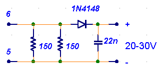

i also want to know how to make a dummy load so the 2N3866don't get baked... can i use a 50ohm/4W resistor in parallel with the output?

light bulb (of the right ohmage that is) is about da best thing u can use for dis job, tune ur circuits 4 max brightness.
if ur using a resistor and it's wire wound, you need 2 stick a cap in series to null out the inductance u work out da value, not me ;)

As a dummy load, you can use a 4W 50 ohm resistor, but your typical 4W resistor is wire wound. You may be able to find some old 2W carbon comp 100 ohm resistors that you can wire in parallel.
A light bulb is much more rewarding, since it lights up when things are working well. 1W into 50 ohms is 7 volts RMS at 150 mA, so a pair of 12V 150 mA indicator bulbs in parallel give you a soft glow when it's working.
NEVER use wirewounds for an RF load. at RF frequencies, they are inductors and are a much higher impedance than their resistance, and for all intents and purposes might as well be an open circuit.

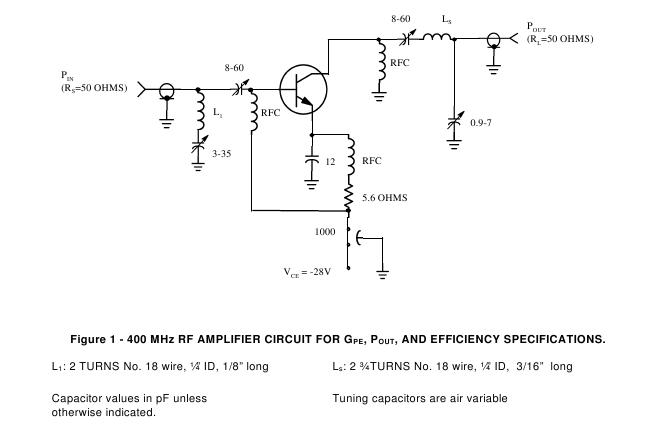

below is the 400Mhz test circuit for the 2N3866. if you DOUBLE both the cap values AND the inductor values, it will work at 100Mhz. if you build an amp, even for 100Mhz, you will need to keep all component leads VERY short. "ugly construction" on a ground plane would probably be the best construction method. with 1W of RF out, the transistor dissipates 5V of heat, so the transistor may have to be heat sinked, which may not be easy, because the collector is the output element, and heat sinking will introduce a lot of capacitance to ground. as for output filtering, use a good 2 or 3 stage PI filter to eliminate harmonics. harmonics will not show up in the FM band, but at around 200, 300, 400, and 500Mhz (assuming a 100Mhz output). 200 and 300Mhz harmonics will be the strongest, so your PI filter should have a cutoff frequency of 120-150Mhz.

sorry 'bout that, must have missed a step in the upload...
the amp below is from the data sheet for the 2N3866
BFG193 has an Ft of 4Ghz, the BC817 has an Ft of 100Mhz. at 100Mhz, the BC817 has no gain, but the power gain of the BFG193 is 15db.

now about the dummy load...either i'll use a bulb as marcbarker suggested or the following circuit...which is also useful to measure the rectified output.

at 100Mhz, the bulb might also be too inductive. go with the circuit you have.

No, that's a really bad idea - it's essential that you use only non-inductive resistors. Place a number of smaller carbon resistors in parallel, to give you the require 50 ohms.
To adjust the transmitter into it, use an SWR meter, a dummy load gives a perfect SWR when the transmitter is correctly adjusted to 50 ohms.
