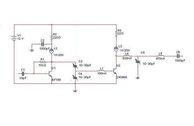

Everybody knows what VK200 is, but nobody has a proper data sheet. :( I guess I'll have to assume it's 550 ohms resistive.
I haven't been able to find the base characteristics of the 2N3866.
is BF199 biased ok? mneary said something about it...i gave him an answer but i didn't got any response.
how can i fix the bias for the U2?
is it really needed R3 to be bypassed with a capacitor?
the output PI filter as i previously said is wrong since i want it for 75ohm load and it's not calculated that well, i also want the impdedance match circuit to be with fixed values, since the RF amplifier is going to be used around 100- 108MHz...l'l try to correct them as soon as i will understand the java applet marcbarker gave me with the smith charts etc.

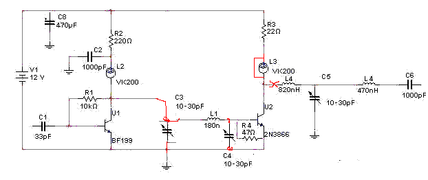

I think I can see what you're trying to do. The series resistors were a good idea, they prevent the transistors blowing up too easily. I take it U1 is amplifying OK-ish?
I think an empirical approach helps. This is what I do with this kind of circuit.
U2 is just not biased right at all, it'll probably run hot too. You need to have a at least a low value resistor between U2's E & B. Start with 47 Ohm.
Temporarily link out L3 and disconnect L4 from U2 C. The resistor R3 wants to be this 'broad-band dummy load' the conversation was about earlier. You definately can't use a bulb here (not unless working with a lower frequency).
Move trimmer C4 to across U2's e-b resistor. It's your choice whether you want to use 'L', or 'Pi' matching. Pi is more versatile. There needs to be a little bit more work here. In meantime for inspiration look at the example schematic that was posted earlier.
And roughly tune C3, C4 for maximum supply current (being dissipated in the 22ohm). This is the start of the empirical stage, the experience you get here is golden. You'll find the routine here almost identical to those Agilent Java 'tuning' applets I posted.
You might might find that one of both trimmers run out of travel, you'll have to suss out that one yourself. You're allowed to 'adjust' L1. It doesn't have to be 180.00 nH and it won't work any better either being exactly that value. But the adjustment of L1C3C4 is critical.
Remove link from L3, reconnect L4. Now you work further along the circuit, doing the same routine with the adjustments.
you mean a 47ohm at the emitter?
what does "link out" mean? i don't know that phrasal verb.. english isn't my native language.. :)
R3 as well as the rest of the resistors are going to be a 1% tolerance...i don't know if their material is going to be suitable for low inductance...

"link out" means "put a short circuit across it"
the 47 ohm resistor goes from emitter to base.

an update of schematic.. marcbarker i'm not sure i did exactly as you
told me...check the design and tell me..

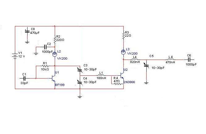

I've attached your schematic which I have 'marked up' (another phrasal verb!)
I didn't realise that english is not your native tongue. What is your native tongue?
I've changed the matching network into a 'pi' matching network. What you ought to do is use roughly calculated values here. Otherwise you often find that a tuning capacitor is not enough pF's.
Any stray capacitance in the circuit and inductance such as lead inductance (and any unavoidable self inductance) will be present in the circuit. You normally are supposed to select components so that these effects are not significant to cause "parasitic effects" (also known as 'sprogging' in slang). You would never be able to eliminate all of these effects, even if you used the best components you can find. What you can do is allow the adjustment of the Matching Network to accommodate this stray capacitance and inductance.
Carbon film resistors (e.g. 1% types) are somewhat inductive. It's because there is a spiral etched into the carbon film. The old carbon composition ones (e.g. 10%) are blocks of carbon.
Ferrite is a wonderful material. It's so 'forgiving' too, if you make design mistakes. When making an RF choke, you'll get the broadest 'flattest' band (lowest Q is good) if you have a single ferrite bead with a wire inside it, but sometimes it is not enough impedance. To increase the impedance, you can get the multiple hole ferrite. That is like connecting ferrite beads in series. I think it's something like 30 Ohms per turn or something (in the datasheet). Too much impedance is bad.
Typical use for ferrite is to put a DC short circuit between the base and emitter of a transistor (operating in 'class C'). The RF doesn't 'see' this short circuit.
i want to get rid the variable capacitors so it's a bless if they aren't needed that much.

marcbarker i have difficulties understanding this weird biasing with the U2...
do you think you can help with that? or i'm asking too much?
