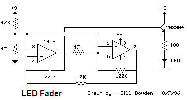

I have had my LED "mood lights" shining on the ceiling for years. They slowly and randomly fade between about 64 million colors and all brightnesses from very bright to off. They don't have an adjustment.
My "mood lights" have three fading circuits operating at very low slightly different frequencies. My circuit uses a capacitor and positive feedback to make the fading logarithmic like your vision's response to brightness, but other people say that this simple circuit works well:

Bowden's Fader fades one LED, how would I modify it to fade an RGB LED?
An RGB LED has a red LED, a green LED and a blue LED inside. If you want all LEDs to fade separately then make 3 fading circuits like I said I did. If you make the timing resistor slightly different for each circuit then they will fade at different rates and the colors will randomly add to produce 64 million colors and all brightnesses.
I recently finish a similar project with the same base circuit. You really don't need to chang the timing resistor, the compent tolerences will give you slighlty different frequencies, which is a little better. Otherwise one color will tend to dominate. Also, I slowed it down by connecting two 220 uF capacitors back to back (neg together, positives goto pins 1 and 2 of your opamp) in place of the 22 uf. This was a suggestion from the origional circuit. You should go to his website, its well documented...
