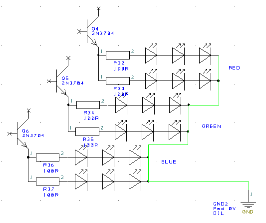

Fade each color of RGB LED's with 555 / 4029
If you can use non-common anode/cathode LED's

So each group of three LEDs would consume only 20mA and require 1 current limit resistor. You might even be able to go back to using the 2N3907, depends on the gain of the transistor.
Oh im totally liking this. The 3907 that is. much smaller. ive got limited room. Im going to lookup how id connect these in a series.
LEDS in a series.
So my voltage will be 12volts. Confirmed.
3.0fv led 150r
2.0fv led 350r
Are you not going to use 8 Leds for each?
You can put the last two of each in their own group with their own resistor.
Also be aware the TIP122 has a lot of gain, so with it you can use a larger value base resistor, which should make the capacitor size smaller. You should test these different configurations before settling on specific values.
LMK if this allows the use of the smaller 3907 transistors
The only thing I can tell you is that the TIP122 will deliver 20mA to each led without making the base resistor so small (and the cap so large) that you loose the fade on/off effect. You'll have to experiment with what works for you.
You might look at using mosfets instead of the 2N3907s. The gate (the base pin of a mosfet) current is effectively zero, so you could increase the timing resistor to 100K (or higher,) with a similarly reduced capacitance.

Did you check the size of 1500uF 10V capacitors? 10mm dia by 12mm long. Instead you've gone with 470uF caps - 10mmx10mm a huge saving of a whole 2mm.
