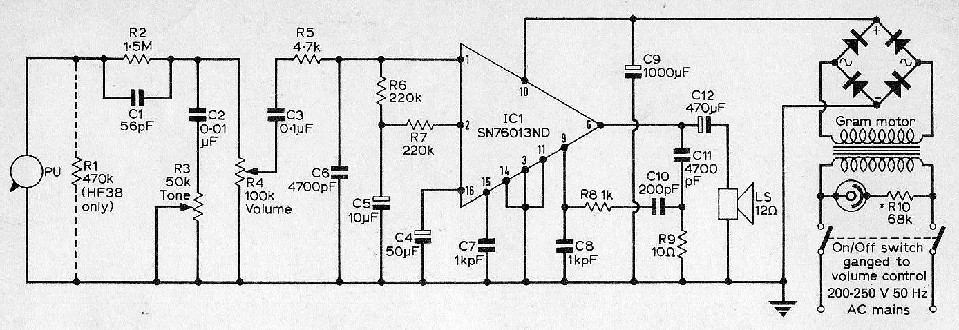

While we're talking about pickups, here's a scanned circuit diagram of a Fidelity record player using a crystal pickup, note the complete lack of any RIAA equalisation.
I just simulated that amplifier, assuming: 470K pickup resistance, 'tone' control at 10% (5K) and volume at 50%.
Rolloff begins at 100 Hz instead of 20; but after that, the curve is within about 5 db of the RIAA curve. Volume control has a big influence due to C6; it's a lot brighter at high and low settings.
What could "gram motor" mean, on the xformer secondary?
It's a second winding on the AC deck motor, used as a transformer to power the amplifier - crude but efficient! :p
I was trying to find an even older Fidelity example, which used a crystal pickup and a single EL84 valve - but couldn't find it.
A record player was also called a gramophone. So it uses a gram motor.
