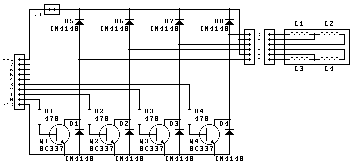

i am driving them with the exact configuration as Nigel has on his site except i am using IRF 510's instead of the ones he is using..

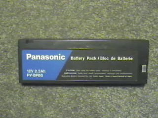

well i've had a pretty good morning..
I found not one , but two 12V 2.3Ah batteries at a garage sale, they came with a Bell Atlantic Special Edition Cell Phone..Very early model..
$3.00!!!
Can U say Robot Power...lol

I would suggesting looking at my tutorial boards, they work very reliably, and I would certainly suggest you have a 5V regulator on the board!.

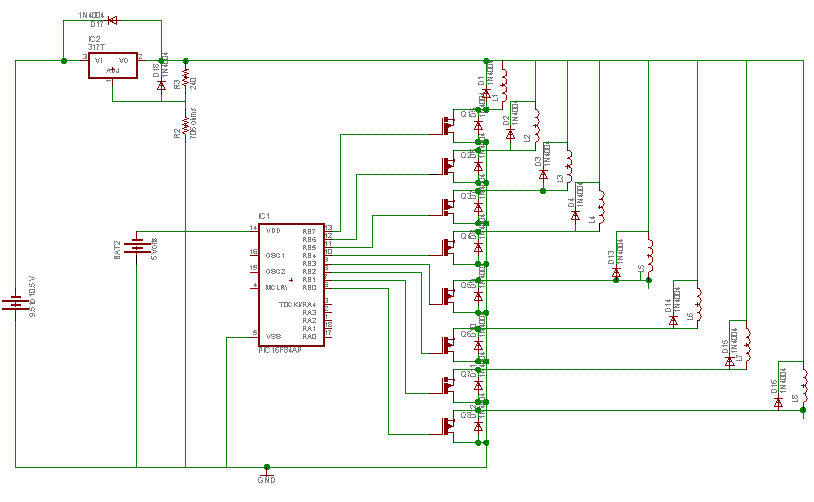

this is my current diagram.
the Eagle software didnt have a 16F628 but did have a 16F84A ..
I think that i turned the wheel by hand causing an induced voltage to ruin the last PIC.. hopefully it wont happen again..
Battery 2 is going to be NiMH 1.2 V batteries giving 4.8 Volts hope this is enough to turn the gates on..if not maybe a combination of batteries of different types will work..

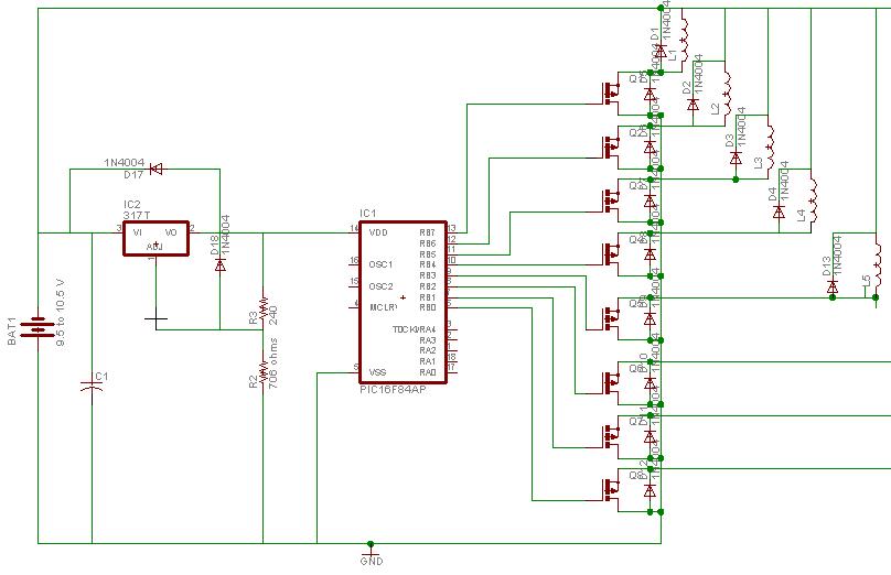

this design is much better..
i scoped the LM317 output , not a blip to be found..
i think this one is a LOT safer for the PIC..
