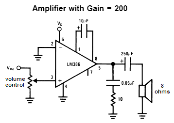

will give it a go tonight. thanks. Just one Q. How do I connect the earphones or speaker. I do not know that simble (where it says audio out to amplifier) Thanks
The Superregenerative Radio Receiver project has another page that describes a horrible little power amplifier project to drive headphones or a speaker.
An LM386 little power amplifier IC as used in the Radio Shack special project can be used instead and performs much better.
Thanks audioguru. Your wonderful! Any specific diagram i can use? I have that ic but no idea how to use it as you suggested. Please!
Hi Colin,
The Radio Shack Special and millions of other circuits use the manufacture's diagram in the datasheet for the LM386 little power amp. The Radio Sshack Special has a 0.001uF capacitor added from pin 3 (input) to ground.
Here is the diagram in the datasheet:
Use the 1nF capaitor, it will stop RF from entering the LM386 which would produce distortion and make wierd noises. It won't make much difference to the audio since the cutoff frequency is above the FM audio band.
