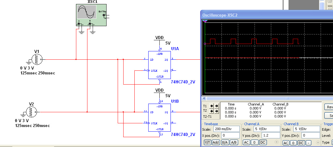

That encoder and 74HC74 work ok in simulation.??
Are your breadboard power rails capacitor decoupled, it could be 'noise'.

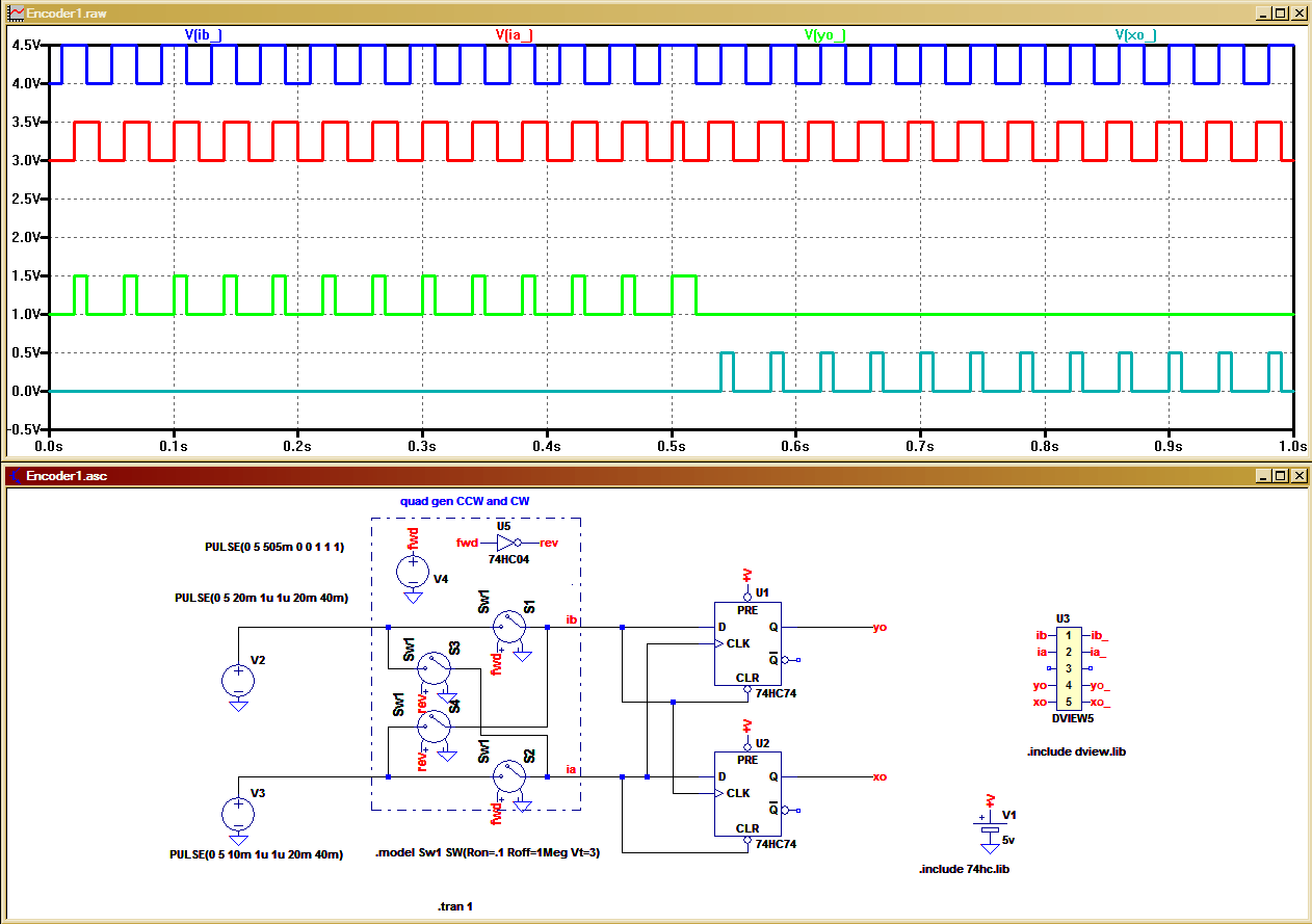

Yes, my simulation is working fine. Mine is not so nice but does the job. I'm simulating the encoder behaviour with 2 pulse sources with 90 deg phase shift between A and B or B and A (CW/CCW).
I haven't placed decoupling caps so I do it now. EDIT: placed 100nF and 1uF, not much changed.
