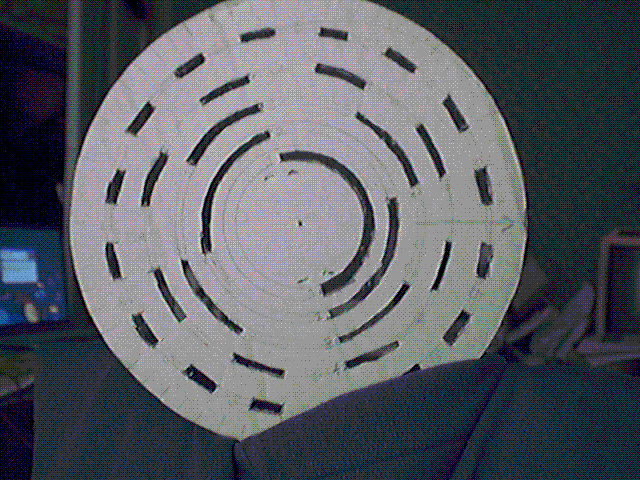

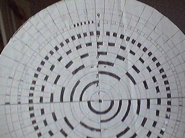

If the size is not important then a positional encoder can be made using very basic tools. Its a disc with concentric slotted circles. The innner circle has a slot cut along half its circumference, the second circle has 2 slots cut in alternate quarters, and so on each sucessive circle is divided by 2. The number of circles corresponds to the number of bits.
A row of light detectors is positioned in a line, from the centre of the disc, over each slot. A light shone from the other side of the disc can picked up through the slots by the detectors .
attached are 2 pictures of 170mm (7") disc prototypes:
The first picture shows a disc made from cardboard as a 'proof of concept'. This was a 5 bit encoder. It used different detectors salvaged from various items. A mains reflector light provided the illumination. (This worked OK but the disc did get rather hot)
The second picture shows a marked up 9 bit encoder disc. -This was never made as the 170mm (7") diameter was too big.
The final encoder used 2 CD discs. After cleaning (to make them see through) they were glued together between a piece of opaque paper which had been cut and drilled to make the slots and holes. It had originally been intended to print the pattern on a overhead projector slide or on a photographic film but the cardboard version worked the best.
LED and Detector pairs, salvaged from mice, were seperated and then glued to 2 booms, one placed on each side of the disc.
The final version (which is still working) was used in a wind vane to give wind direction. Althought it was able to give a 7 bit output only 6 bits are used. Thr eason was that it was fed with a 4 pair alarm cable. After one pair was used for power there was only 3 pairs left. It was decided to keep the external head as simple as possible as I don't like heights.
I trust the above is useful and gives you some ideas.
