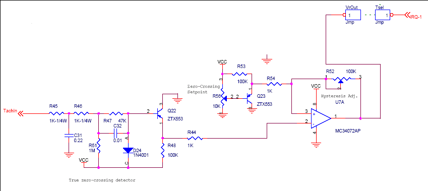

I found on the net this circuit, can cou explain if it is usefull for me to use.
The biggest thing is if i need to use the special components wich are used.
The VR sensor would be connect to the left input and to ground.

I would imagine it would be useful, but again, without knowing what your sensor outputs it's just guesswork?. There doesn't appear to be anything special used in that circuit, what are you concerned about?.
well
The circuit you see is used in the mega squirt system.
Mega Squirt is the DIY injection system.
That system uses the VR crank wheel sensor to be able to know when the cylinder is in his upper position.
enfin,
i think that with that scheme my abs sensor should work.
Mega squirt is build to be able to accept a wide range of sensors.
also i looks like it uses the 0 passing as the signal and not the high going pulse of the sensor is this right?
any way when i look at the datasheet of the transistor it looks like a special one? i compared it with the BC547 but wy does this one have negative values?
could i use the 547?? or do i need to order this one??

There's nothing special about the circuit, a BC557 (NOT a BC547), should be fine - notice it's PNP.

How much % change do you give me that with this circuit the sensor will work?? using a PNP transistor??
I don't know, there's not much gain in that circuit, but the comparator looks like it switches at a fairly low level. Why don't you just use an opamp to amplify the signal from the sensor? - the snag been of course that you don't have any idea how much gain you need!.

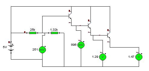

If i would use a darlington transistor array wouldn't that be of any use??
Or some bs457/bc458 after each other shouldn't that amplyfy the signal??
isn't there a way to calculate what voltage producec a coil wich has 1000ohm initial resistance... and when you move something arround it gets to 800ohm and 1300ohm...
How could i make my adc scope sow it will read a usaable value??
1Mohm to ground to adc pin..?
and 1K to adc pin and as probe??
Tks
You can use any type of amplifier, I only suggested an opamp because it's so simple - but it still comes down to you don't know what the initial signal level is!.

With 3 transistors cant you give me a idea with 3 of them??
to opamp the signal..??
i want to do something this evening/night..
assume the voltage it gives is 0,25 volts..
Tks
Just try a single transistor amplifier, in common emitter mode, and AC couple it - you can alter the gain by bypassing the emitter resistor with a capacitor. But you don't know what's going IN, nor what's coming OUT, which means you're working blind.
