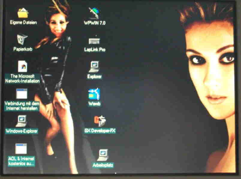

The first is a combined multimeter with integrated oscilloscope (brand Unitrend) and the second one is a fully functional Toshiba Libretto CT50 palm top with windows 98 installed.
The palm top has no USB interface but is very small (taking up little space on the workbench) with a display size of 10" diagonally, which I could use to display the oscilloscope with higher resolution than that provided by the LCD-screen in the Unitrend multimeter.
The Libretto has a full functioning (bidirectional) serial port which I used to program SPS devices while laptops generally fail since their serial port doesn't allow handshaking operations.

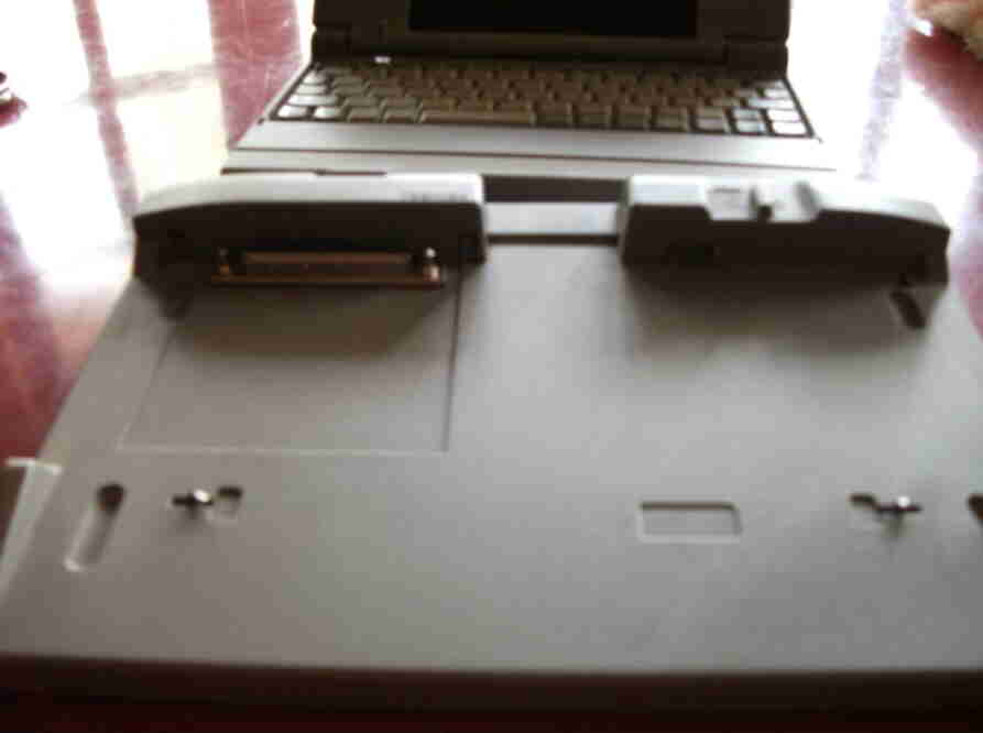

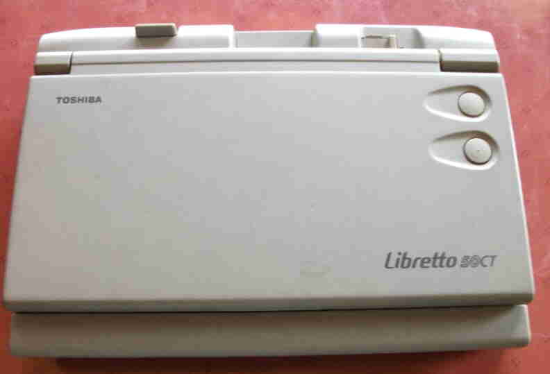

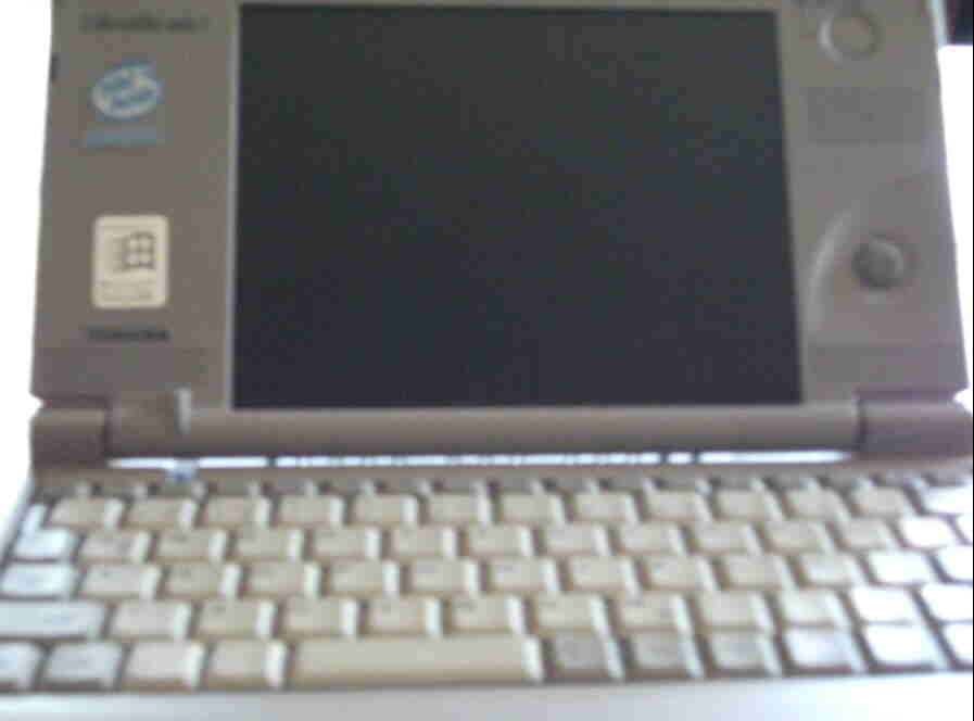

it's a Libretto 50CT including a docking station. The bare device doesn't have any external connector except for a card connector for CD-ROM or floppy drives.

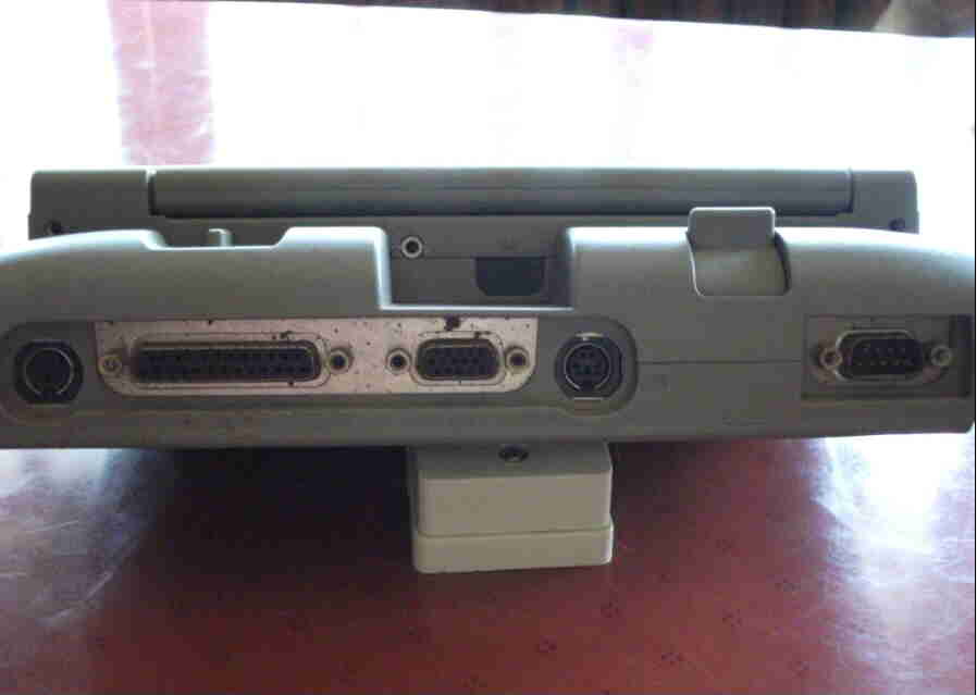

The docking station has a serial port, a 15pin high density video connector, a parallel port and two PS2 connectors to connect external mouse and keypad.
Connectors from left to right: mouse, parallel port, video connector, keyboard connector, serial port.
As already stated, the serial port is capable of handshaking.
It must be a quite old model since it was optimized for windows95, but works with windows98 like a charm.
