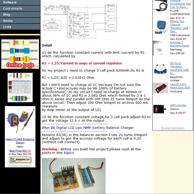

"http://www.coolcircuit.com/project/lipo_charge/charger_circuit.jpg'
The webpage cannot be found.
Most RC chargers do not charge each cell individually, they charge the whole battery and discharge the higher cells to balance, then charge again and repeat until all are charged at the same level.
To charge multiple cells individually, you will need an isolated supply for each cell, ie an inverter circuit for each cell, and a control circuit for each cell. Expensive RC chargers do this, which partly explains the huge price difference between cheap and expensive ones.
From an RC modellers point of view, the only safe way to charge them is in a fire-proof container, either metal or a "lipo bag".
Seems that boeing haven't found a safe way yet either :)
Hi Audioguru, I think this is it? I'm not too keen on a circuit with heat sinks, for me it's not a good sign :)
Cheers, Camerart.

The circuit is too simple and seems to be very old. A lithium charger IC is MUCH better:
1) The circuit is supposed to measure the voltage of a discharged battery and either refuse to charge it if its voltage that is too low or it might attempt charging at a low current until the voltage is normal. If the voltage does not become normal then it will refuse any more charging because the battery might be defective (then it might catch on fire).
2) REGULATED charging current is not needed. Simple current limiting is fine for a charger.
3) A lithium battery is only 70% charged when its voltage reaches 4.2V per cell. A circuit must detect that the charging current has dropped to a few mA then disconnects the charger from the fully charged battery.
