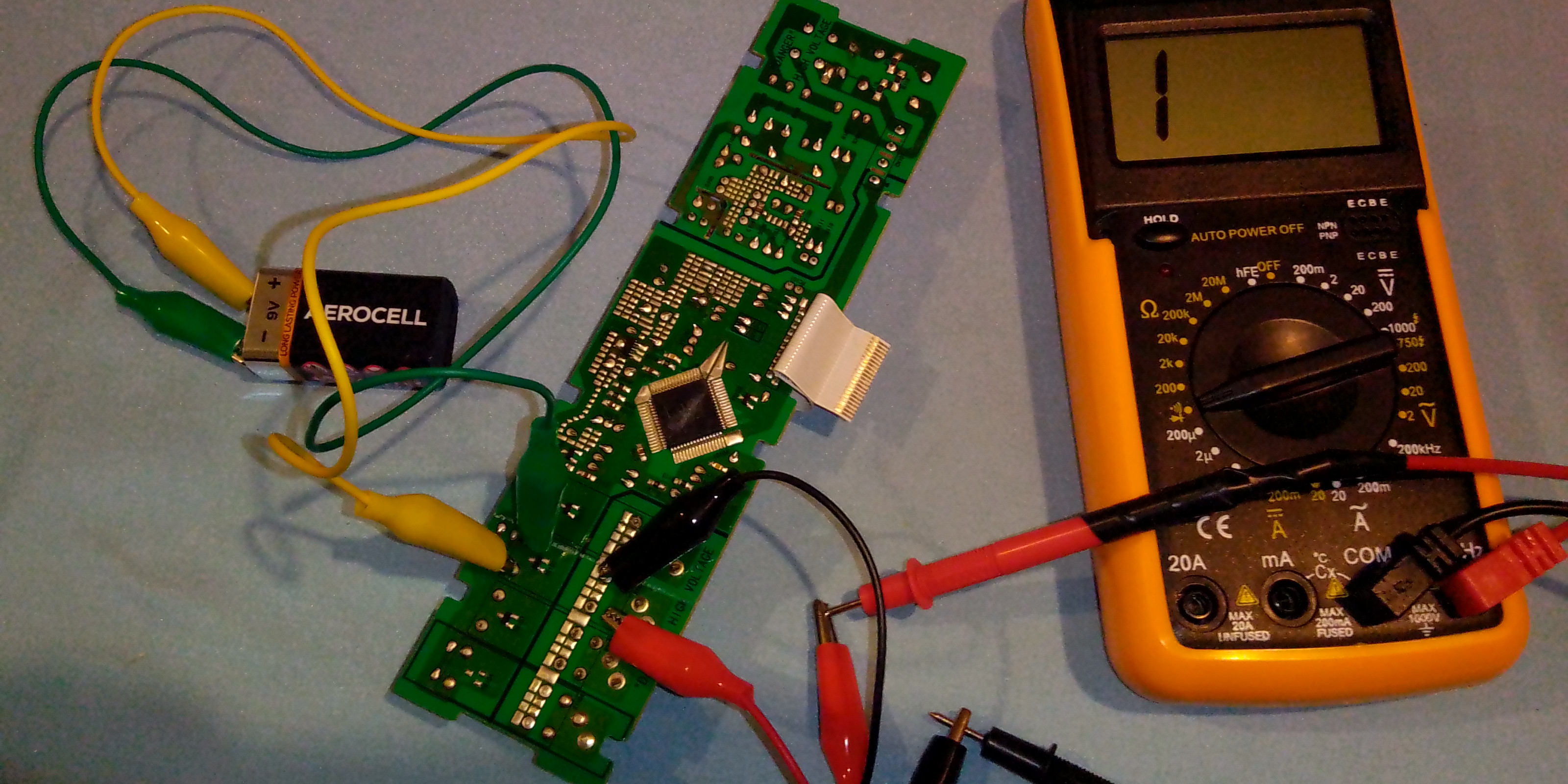

I have disassembled the hob, and I have taken out 2 PCB boards.
The first one is the touch board and second one is the main board.
Here is what I've checked so far:
- heater elements are good
- ribbon cable is good
- relays have coil resistance about 345 ohms (360 is in Datasheet) which is ok
- relay terminals when switched OFF are in open state
What I plan next to do is to connect 9V battery to coil terminals to check if relays are switching ON.
Here are the images:
I've tested all relays with 9V battery (datasheet states that coil needs min. 8.4V).
The middle (RED) relay doesn't switch ON, while two outer ones (BRN and ORG) switch ON.
I can hear two outer ones click and terminals have continuity, while the middle one clicks very faintly and it doesn't have continuity (as you can see in the image).
So, the middle one (RED) is faulty.
Red wire goes from middle relay to bottom heater element, so this is the reason why is not turning on.
